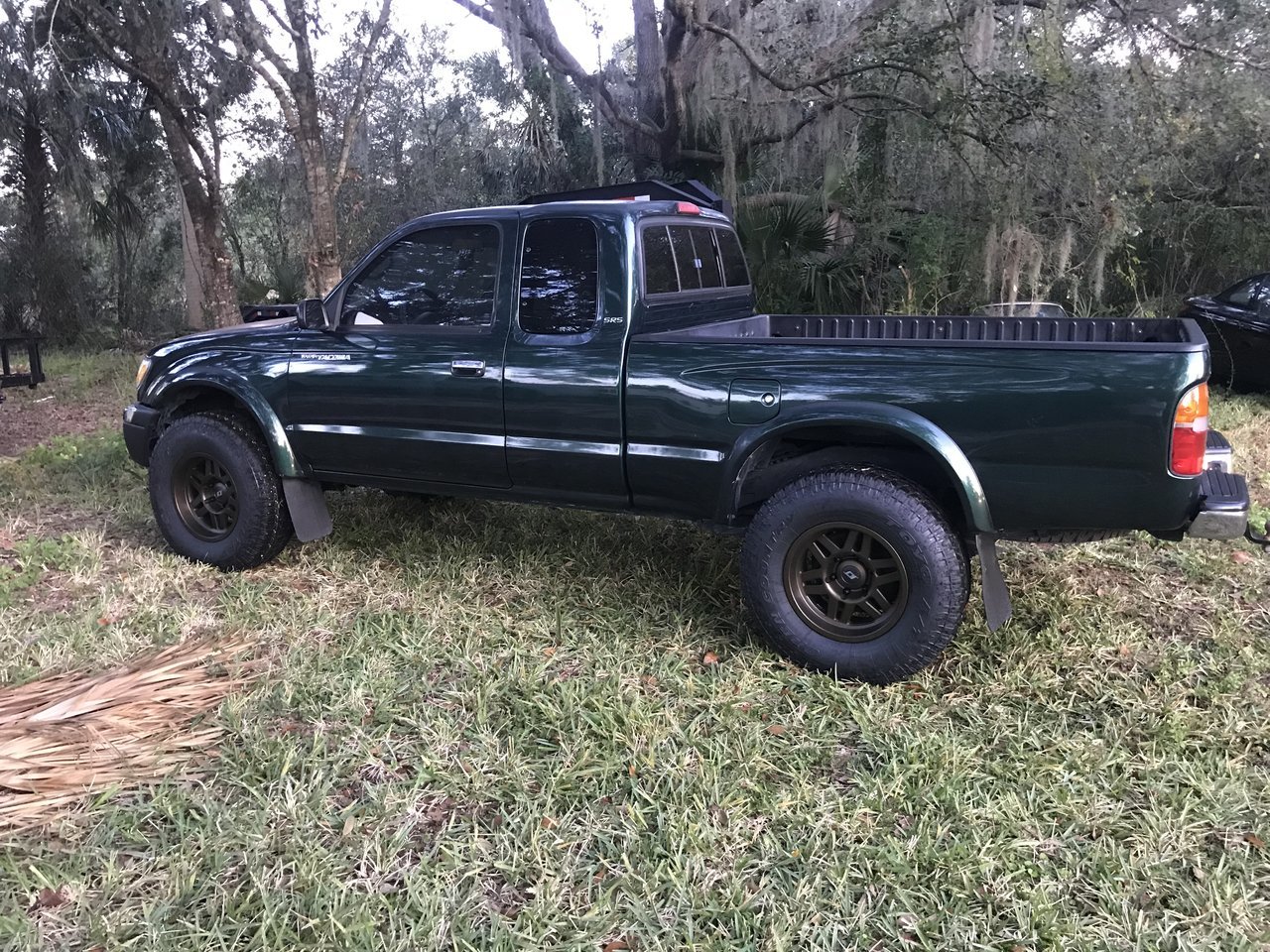

    Vin creates all his wheels to fit the Tundra brake upgrade and 2nd gen Tacoma's (same size calipers). You're good to go and gave me an idea of what the 16 bronze 6's would look like on my 99 4runner in the IJM color. Looks great!

    Thanks the bronze looks it was made for the IJM need to get some good pictures in the sun
