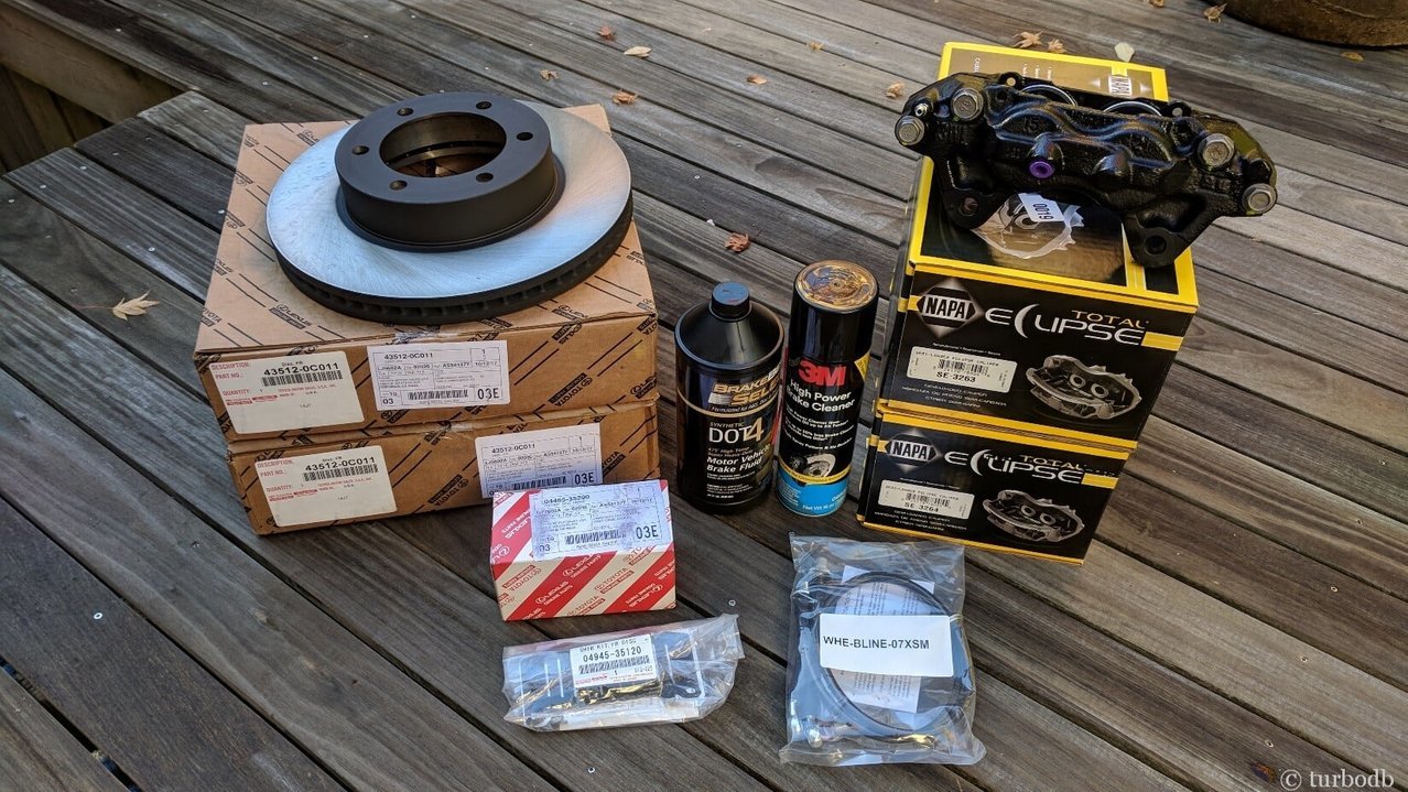

    I'm looking on wheelers offroad for the brake line kit...kind of confused which one I need for this upgrade. Would this be the one?
  4. Jan 2, 2018 at 2:07 PM
    #44
    turbodb
    turbodb AdventureTaco
    Feb 9, 2016
    #177696
    8,535
    Dan
    PNW
    2000 Tacoma Xcab 4x4 SR5 V6 TRD
    AdventureTaco
    Those are the ones. I have a list of everything you need in my post here, with links:
    New-to-me Tires and a Tundra Brake Upgrade (write-up with pics)
    y4mYqx8SS3jgCxbC4e5AEOhAMGM0ykwkpIbL9rrv_46c8e65227815f207916b4f8fad75263a85b571b.jpg
