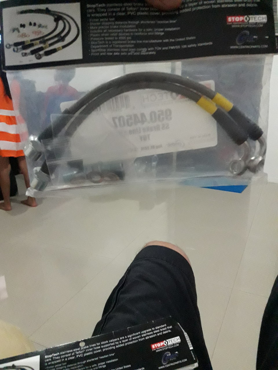

    So i bought the 231mm upgrade and ordered stop tech ss brake lines.
    It is a 2 piece kit??????
    Anyone have pics of the line kit 950.44007 installed.
    I don't want to get it apart and not have a part to finish. There are NO tundras over here.
    The kit is 4 lines 2 for each side. Last set of lines i bought were one piece. I cant see much since its not on a lift.

    Not the correct ones.

    Should be three lines, Two front should be the same and only one rear.

    Guess what the caliper bolt pattern in thailand is different the kit wont work.. fuuuuuuuuuuuuuuùuuun
