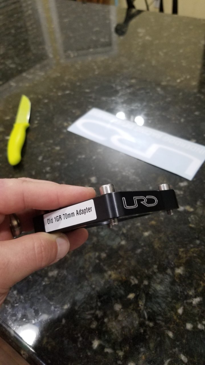

    Just installed a 70mm throttle body on my 08 6 speed. Went for a quick test drive. ZERO cel, idle was normal too. I ended up making a paper gasket for between the tb and the adapter. I scored on a used throttle body for $85 shipped. Doesn't seem to be much more power increase but first 1/4 part of the throttle is much more responsive. Similar to what the pedal commander felt like for the day I tried it. I really just wanted to grab an adapter before they weren't available anymore. Thanks for all the info!20191204_201817.jpg

    Is there a reason they may not be available in the future

    Well the 76mm ones have been sold out for..........ever, so I didn't want to miss my chance.

    What year Tundra TB's can be used?

    All years. All the info is on urd site.
