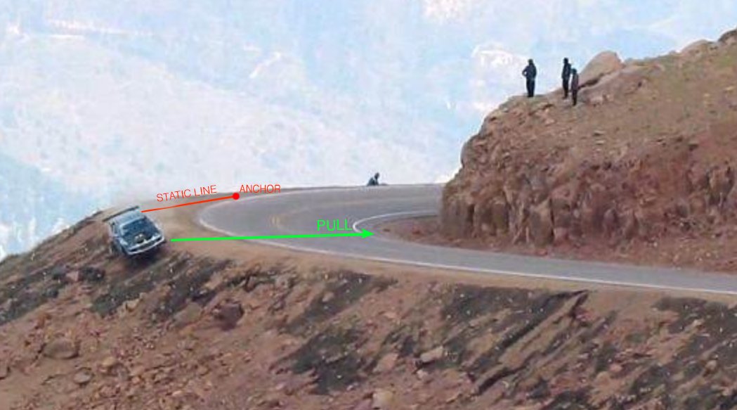

    I pulled a Subaru out of a situation like this by attaching their back end across the trail to one anchor with a static rope (could be a truck behind it with good traction), then pulling them forward with another line. Not sure if that's what you meant by having a tree behind and above, but this worked and kept them from sliding further downhill. In rescue class they taught us to drive anchors into the ground (long metal stakes driven in at angles with sledgehammers) if nothing was available. Major PITA, and for a vehicle it might have to be multiple anchors working together.
    Maxtrax sounds better, but if I were hanging off a slope like this I still would want a safety line regardless, as the pull line on its own will still let the vehicle slide further down.
    If you set up a recovery like this, you want the angle between the two lines to be as acute as possible. Even better would be running the pull line through a snatch block on the vehicle-to-be-recovered then to the rear anchor, if the vehicle-to-be-recovered can accommodate that. Without a snatch block that can be positioned in the right place I'd be tempted to use even an uphill rock slider as a snatch block, if available.

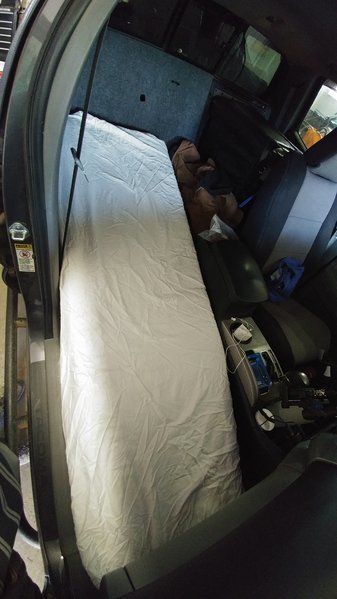

    Sorry to go with an old thread, any more details on how you built this? How long of sleeping space do you get, is it more than just sleeping across the back seats?

    Might have more details somewhere in the thread but it was a few pieces of plywood that were mounted to the stock seat locations. I'm 6ft and i had room to sleep lying straight, can't do that in the back seat.

    o_O may have....sort of quoted all the posts I could find, for easy reference in the future BUT I did also have another question:
    Related to this:
    https://www.tacomaworld.com/threads/front-passenger-seat-removal.559102/
    https://www.tacomaworld.com/threads/removing-front-seats.583041/
    Did you run into anything with sensors, airbags, etc etc?
    Did you build it with any effort to make it "modular" in that you can "easily" take the passenger front seat in and out again? I am looking to do this instead of RTT, but one thing would be if it can be a, ballpark, 15 minute job to get the seat back in. MAYBE happy to do it in 20 minutes, just curious if you took that into consideration or decided "Sod it, it's staying out".
    Thanks in advance, this is legit and if it works I think this will be what I do for next year at least!

    Hey Stig, I'm back! Done a lot more research into the airbag stuff, and now I'm all set ready to pop the bolts and pull the seat out. The drivers airbags will still function, and the passenger reset isn't terrible.
    ANYWAY I'm going to use your thread as basic inspiration. I noticed in this picture it almost looks like there's a lip between the platform and the storage bin from under the rear seat. Is that my eyes playing tricks on me or did you have a lip and the mattress absorbed it?
