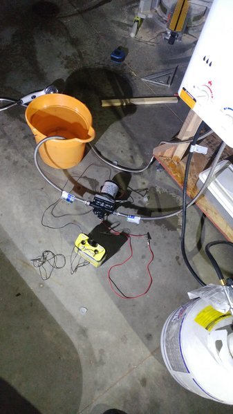

    Testing the water heater. I wanted to make sure that if I mounted the heater in the bed, I would not be melting the ceiling and starting the topper on fire. No worries, its not hot at all coming out the top but I'll probably put some heat wrap on the headliner above it just to be safe. I may even recess it below the divider to give it more room above.
    Water in the bucket was 49 degrees, pushing it through the heater at nearly the lowest heat setting brought it up to 100 degrees. I turned it up to max heat and that was 140+
    That size bucket should last 2-3 minutes. Plenty enough for a shower. Now the fun part of trying to find the appropriate fittings to make it work. Biggest thing is I plan to use a bucket either from a river, or an extra 6 gallon jug for the shower, it'll be placed outside, connect the hose to the panel on the side of the truck and drop it in the bucket. Connect the shower hose to the panel, turn it on and you're good to go.
    It'll be one of the projects I have to finish this weekend. The other is removing the passenger front seat and building a platform for sleeping. The memory foam mattress topper for that arrives on Tuesday, and I've got a nice camping trip scheduled Thursday-Sunday.
