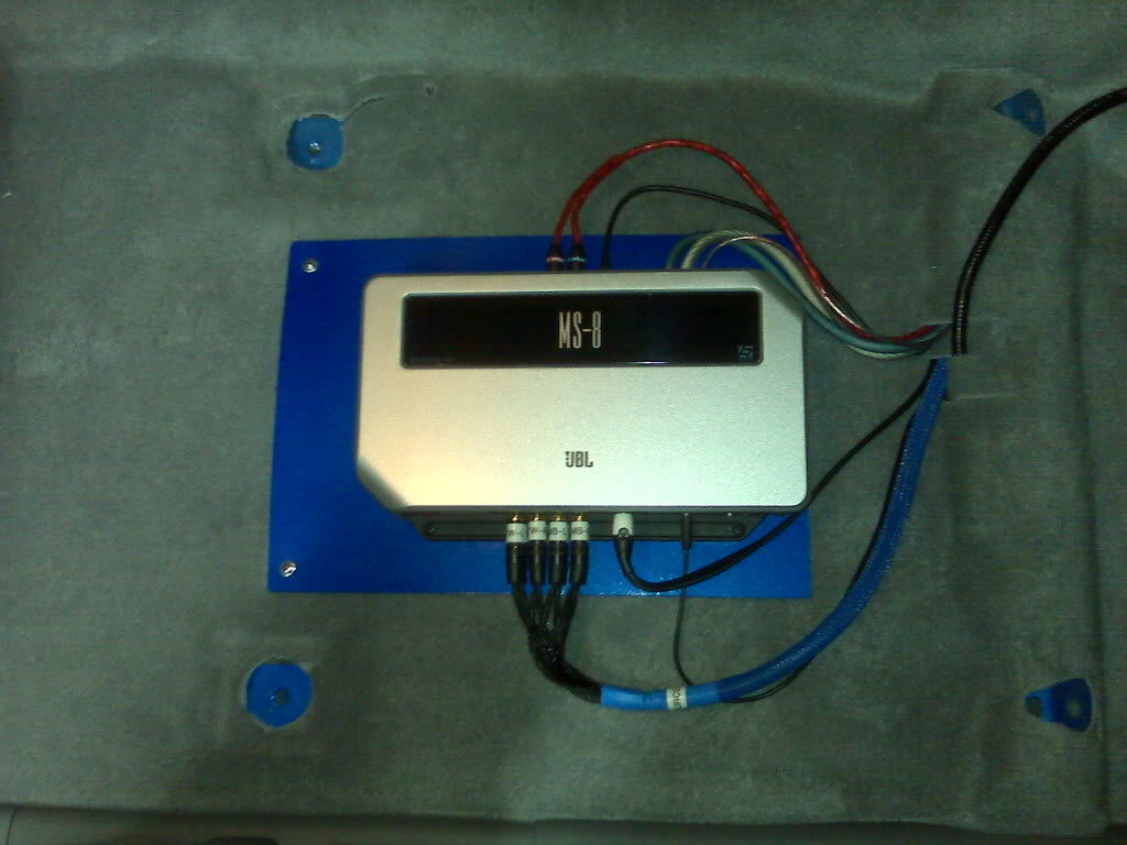

    No no no...The MS8 is in and it will be getting replaced by the bit 1. The MS8 and I don't get along. I have not been able to get good results with it and you can't do time alignment on your own with it so I need something that gives me more control.
    Little eye candy though. I wish it worked as intended; had great potential.

    That's a pretty nice unit but I wasn't aware you could not do time alignment yourself which probably makes it a deal breaker for me as well!

    Hopefully I saved you on that large purchase. I almost lost my butt on this unit!
