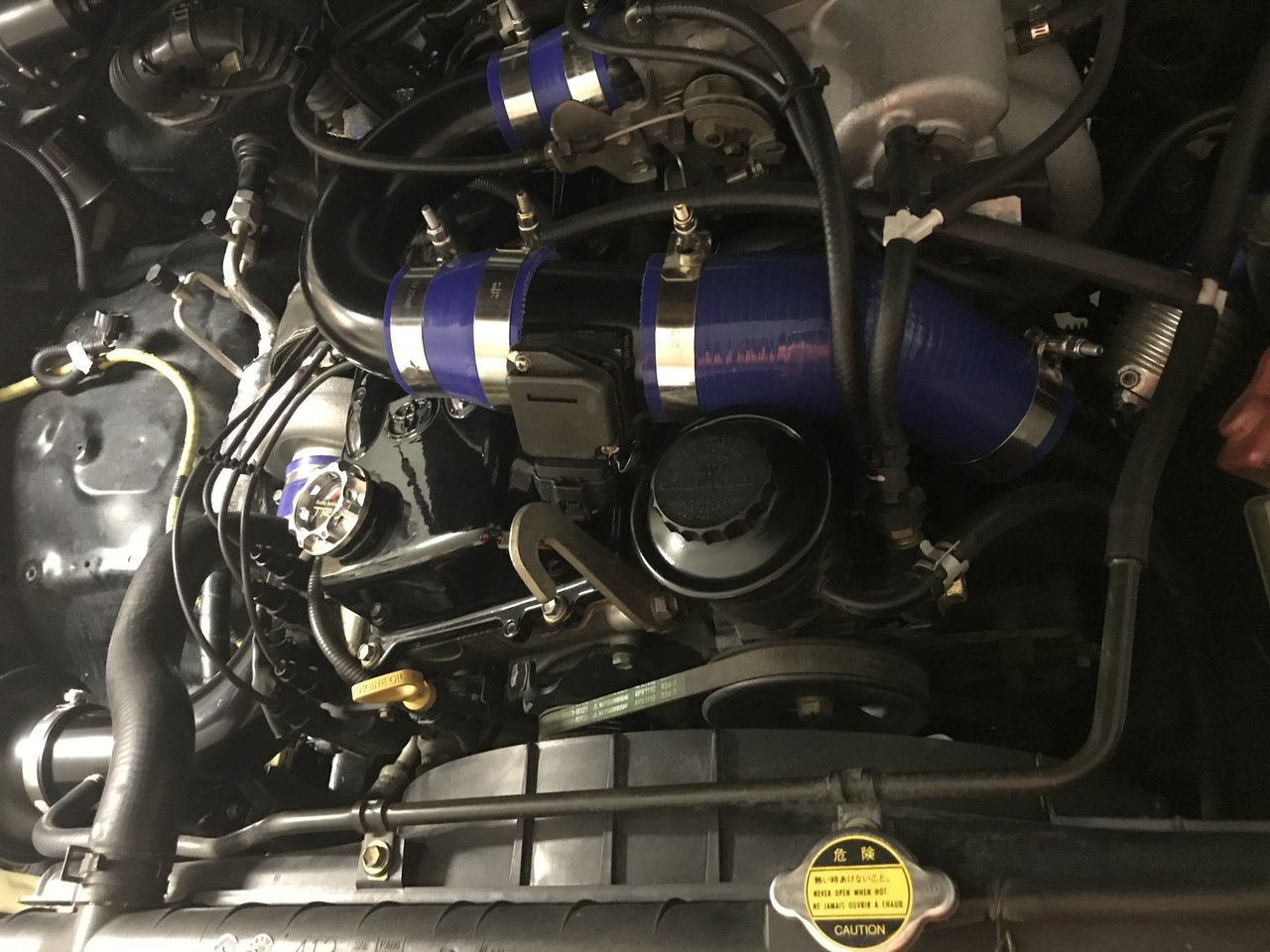

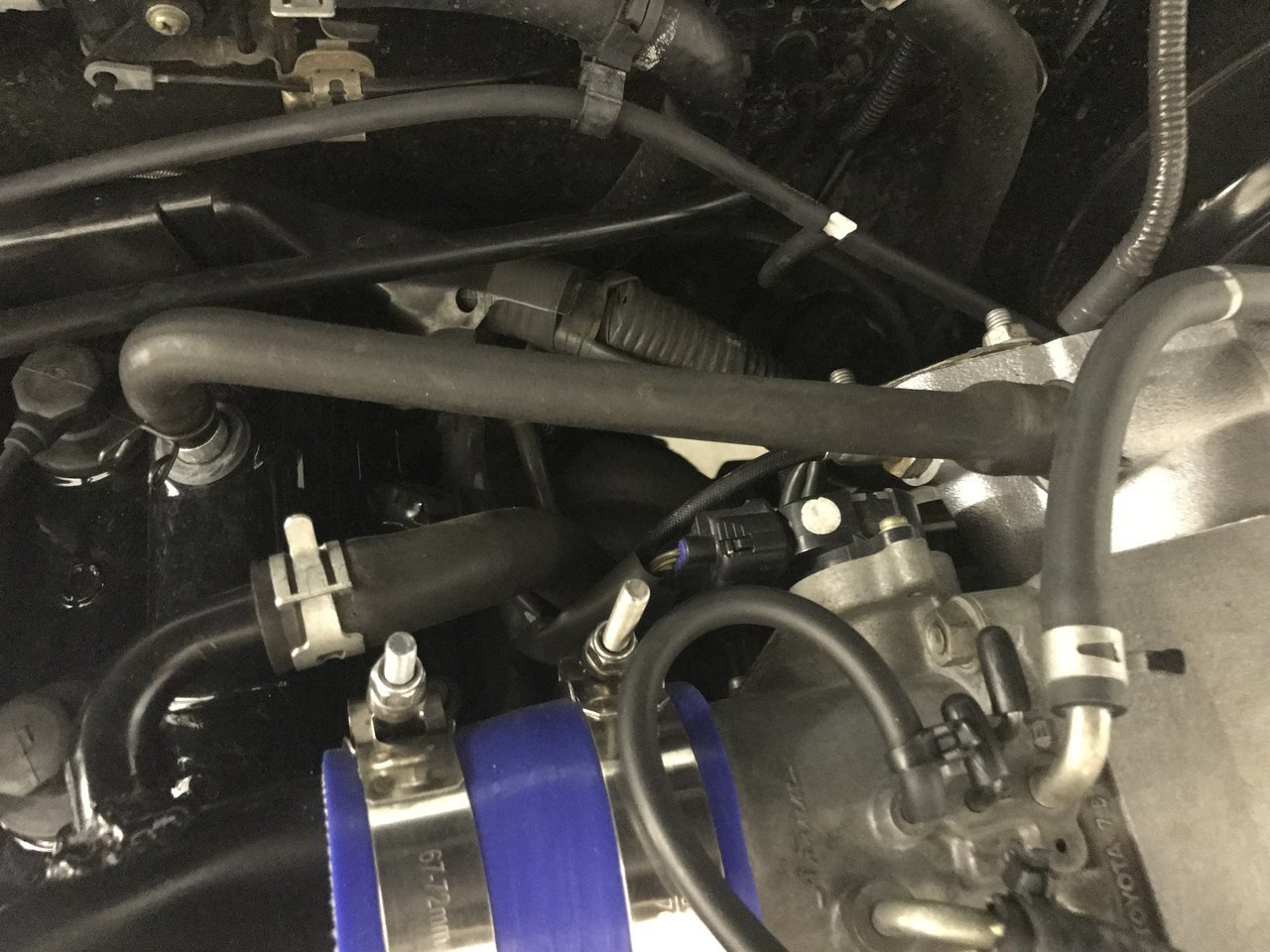

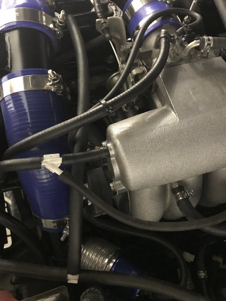

    Yeah right after the air filter. I can dig up some pics when I have a chance
  19. Aug 19, 2017 at 7:56 PM
    #2099
    boostedka
    boostedka Well-Known Member
    Sep 29, 2011
    #64367
    6,041
    James
    NM
    2013 DCSB 6MT, 2004 4runner
    Pics :transformer:
