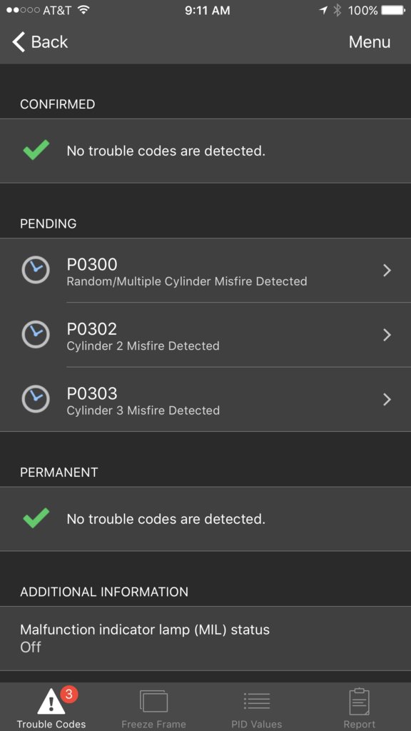

    Did I push too far and mess up the engine:annoyed::facepalm:IMG_6058.jpg

    I'll have to drive it home like that later and do a compression test :facepalm::facepalm:

    No, youre fine buddy. If you have a massive vacuum leak, the engine will misfire horribly. They are only pending so they are not currently happening but have been recorded for analysis now.

    It happened after a 2nd to 3rd gear pull after letting off I fear the worst but I'll check compression and see what happens but it's barley running

    I would check all your connections again... sounds like something worked its way loose during the pull.
    If you messed up the motor, you would see stored, active codes for issues. Not pending ones. Your check engine light would also flash if you are experiencing 50% or more misfires, which indicates a serious problem. Don't freak out too bad, verify everything is connected and then we can entertain engine damage if the issue is still there.
