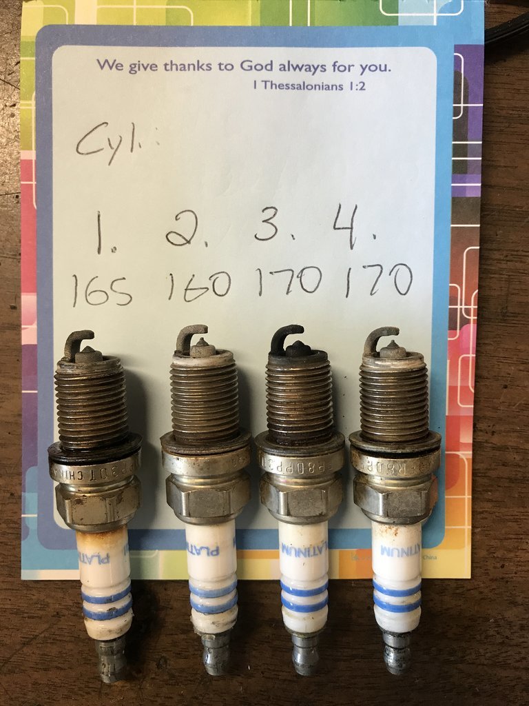

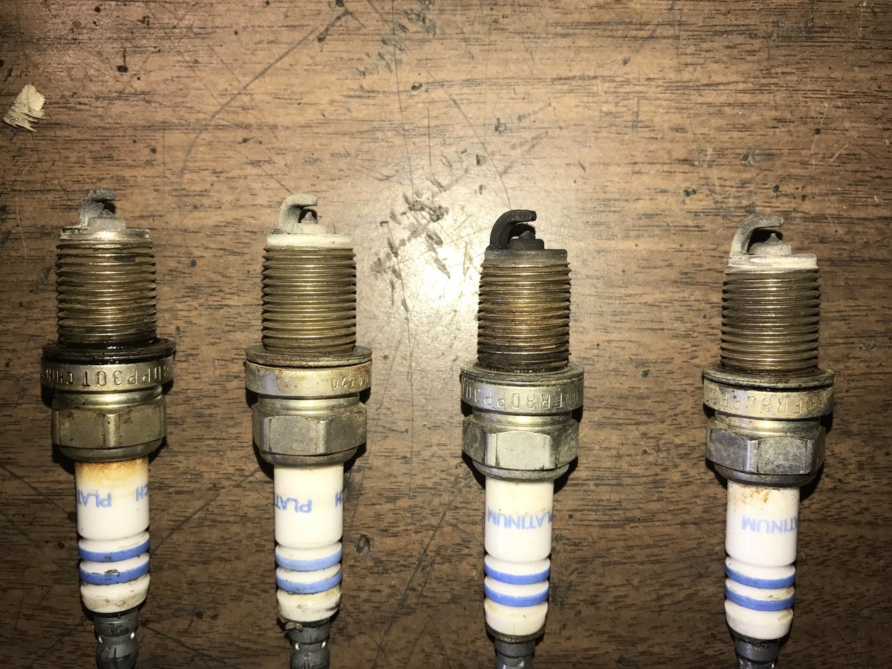

    Two of those are definitely done for!

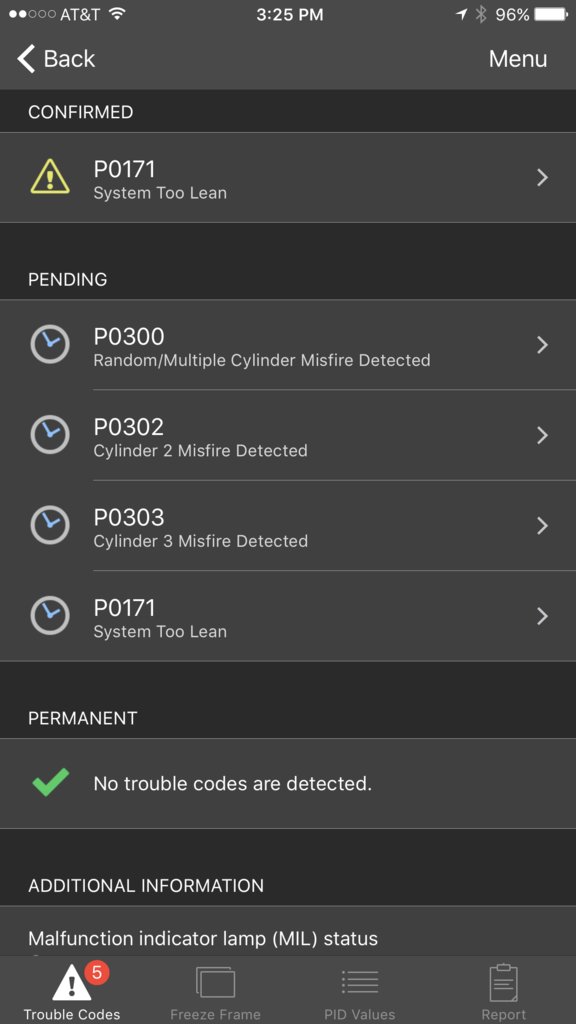

    You cleared the codes first before going for the test drive?

    That was just from idle in the driveway I'll reset the codes and go for a test

    If you have a lean code while idling, go easy on the test drive.

    I would like to know your fuel pressure too. The lean code is a part of the puzzle now lol
