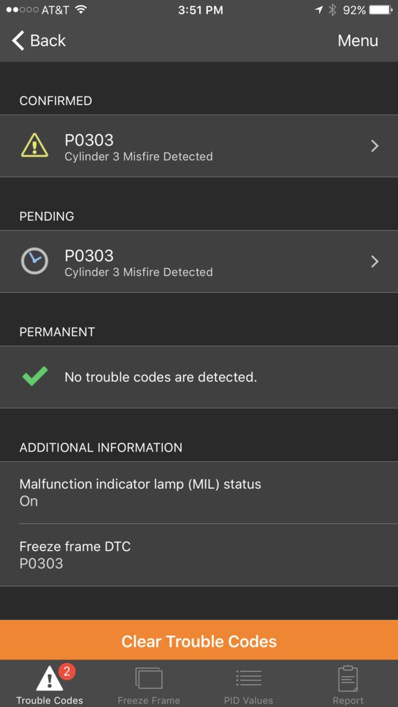

    The check engine light still comes on at idle but this is the only code I get nowIMG_6061.jpg

    Now we are getting somewhere. The 3 plug definitely looked the most melted and then adversely carboned up.
    Check the injector connectors and harness back to the main wire loom for any disconnections, exposed wires, or broken connectors.
    Also inspect your plug wires for any breaks in the insulation

    First I need to go get spark plug wires because pull the wire out of one of the plugs

    So I got new spark plug wires checked all the wiring for the fuel injectors put everything back together now it's good o_O

    Yep !! it must have been the spark plug wires and maybe the connector for #3 injector was loose:notsure:
