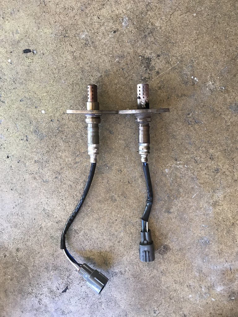

    image.jpg image.jpg Here's the original sensor next to the new one

  9. Sep 6, 2017 at 3:57 PM
    #2429
    boostedka
    boostedka Well-Known Member
    Sep 29, 2011
    #64367
    6,063
    James
    NM
    2013 DCSB 6MT, 2004 4runner
    Did that one end up working out?

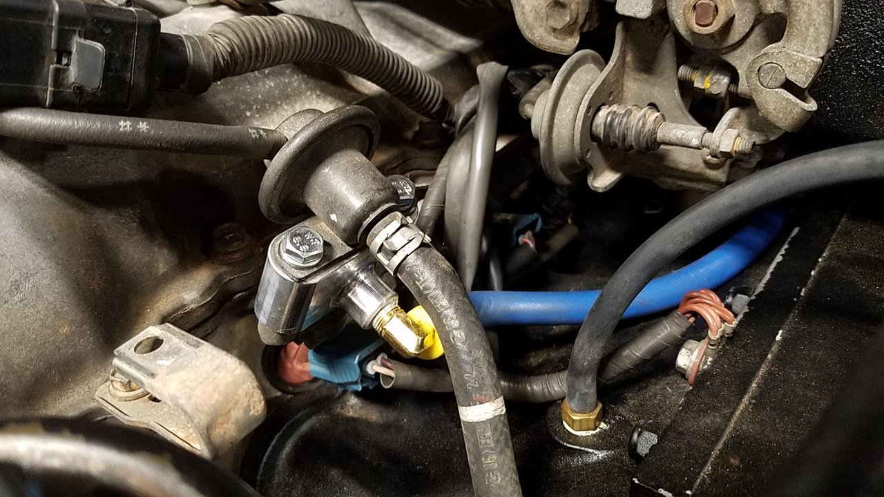

    Couple pictures of my setup...Any reason to remove EGR valve?
