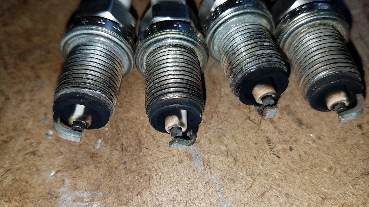

    Sounds like pinging to me. Get the pump in ASAP, as well as that AFR gauge.
    A snorkel will also reduce boost. As it is like trying to breathe through a straw.

    What did the gap measure on them?

    .031

    That seems pretty good. Maybe the one step cooler will help out along with the suggestions torspd had as well
