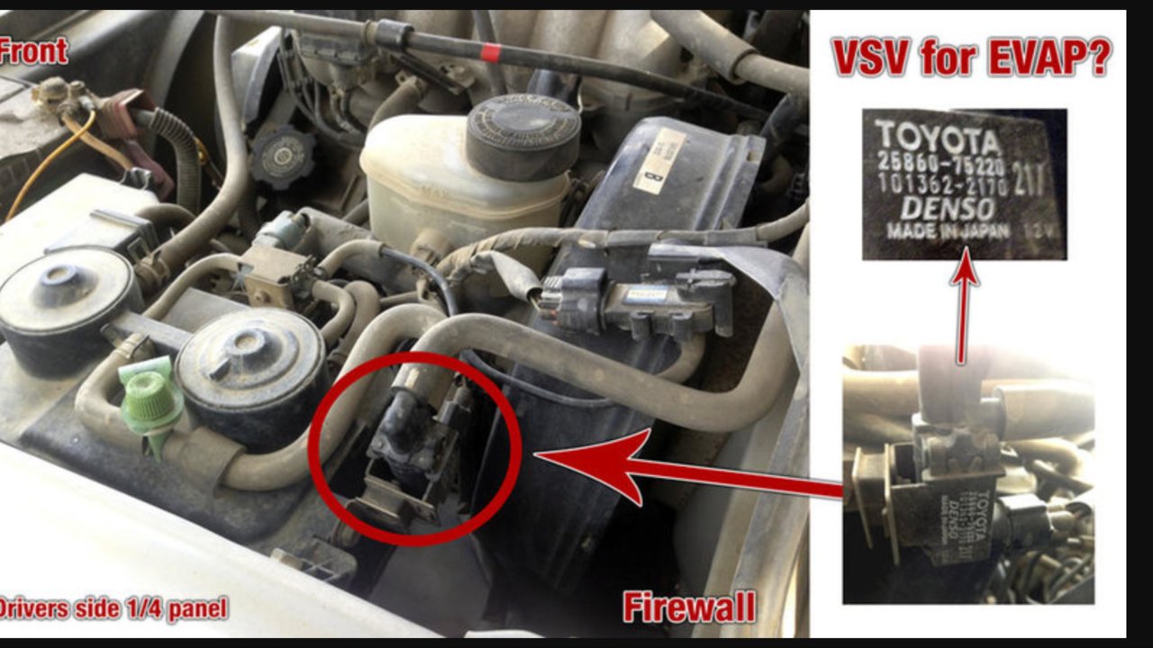

    @GioGuitarDude could you are take a picture of the valve I'm looking for?

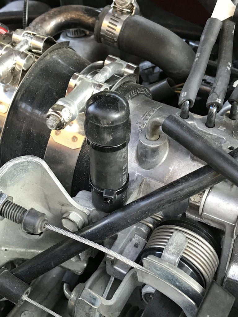

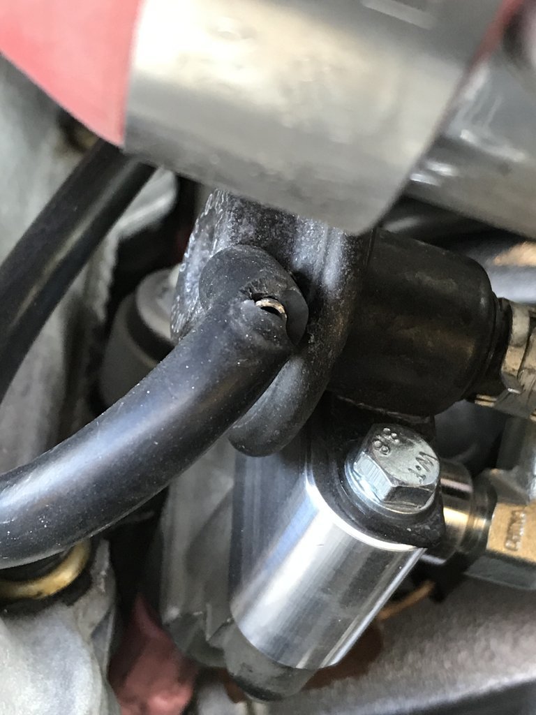

    The vacuum line that goes to the fuel regular Today I went to hook up the fuel pressure gauge so that I can see it when I'm driving and before I got it all hooked up I noticed these two things which solved all the problems for now IMG_6096.jpgThe vacuum line that goes to the fuel regular was broken and the large plug on the throttle body was completely missing :facepalm:IMG_6095.jpg

    That will cause some major vacuum amd operational fueling issues.
    If your silicone cannot be bent in half, twisted, contorted, & stretched, then you should look at a rubber braided hose, or a better brand silicone. Just for keepsake.
    Definitely need to get a wideband installed. It will instantly show you if there is an issue. It is an invaluable tool.

    GioGuitarDude
    GioGuitarDude Well-Known Member
    Jun 18, 2013
    #106509
    959
    Gio
    96 TURBOCHARGED 5 speed X-cab 3.4 DLX tacoma
    Cold air intake
    My setup is a tiny bit different but this is basically it... on a 3.4 anyway
    boostedka likes this.
