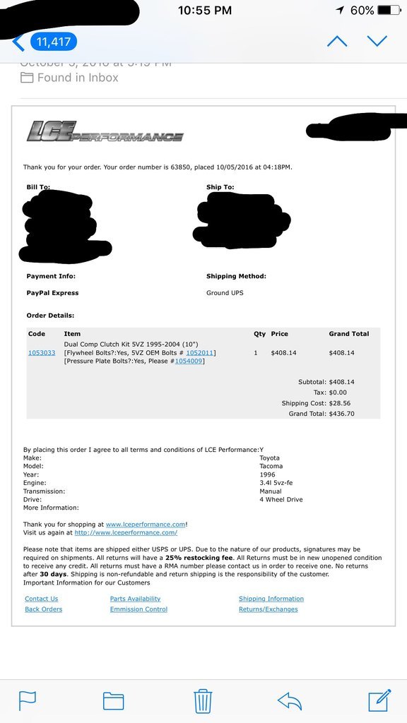

    I ordered my clutch from LCE and I've been loving it. No issues

    Pretty sure the last clutch was an lce clutch in the truck. Not knocking on the product just the customer support.
