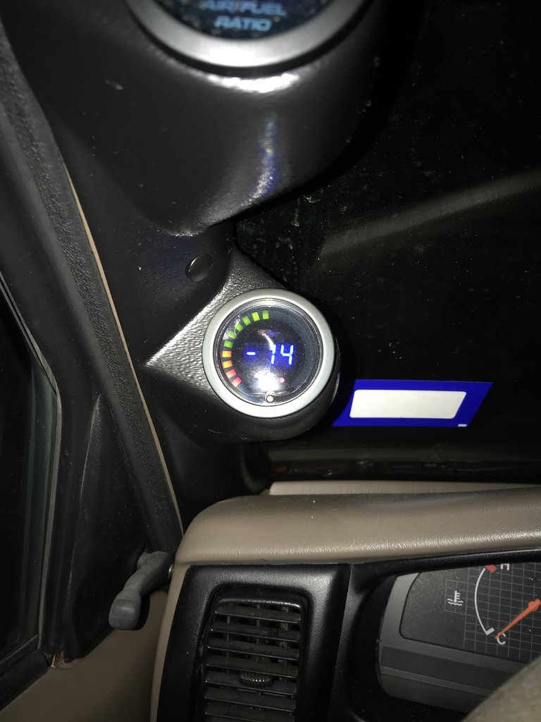

    I started up the truck just now to go to work and for some reason the vacuum high between 13 and 15 but it changed after it warmed up back to usual. Is it the gauge or part of the issue. This has happened before a few times6E3AC169-8BC8-490D-9237-64FDB6BDCBB3.jpg

    The gauge or the sensor

    Increased load would create a more rich condition. If that is what yours was doing, running more rich than usual.
    A clear indication would be referenced against a known good 'normal' operation. The boost gauge would read a specific amount of vacuum at a set cruising speed.
    Increased drag from a failing component, would increase the load on the engine, referenced to the above vacuum, at that same cruising speed. Reading less vacuum on the gauge. Which could then, depending on how your tune is, also show that the AFR is more rich. Since the needle would be closer to atmosphere, on the boost gauge.

    Next week ill be putting in the wide-band AFR gauge and re welding the down-pipe so ill see whats going on i hope
