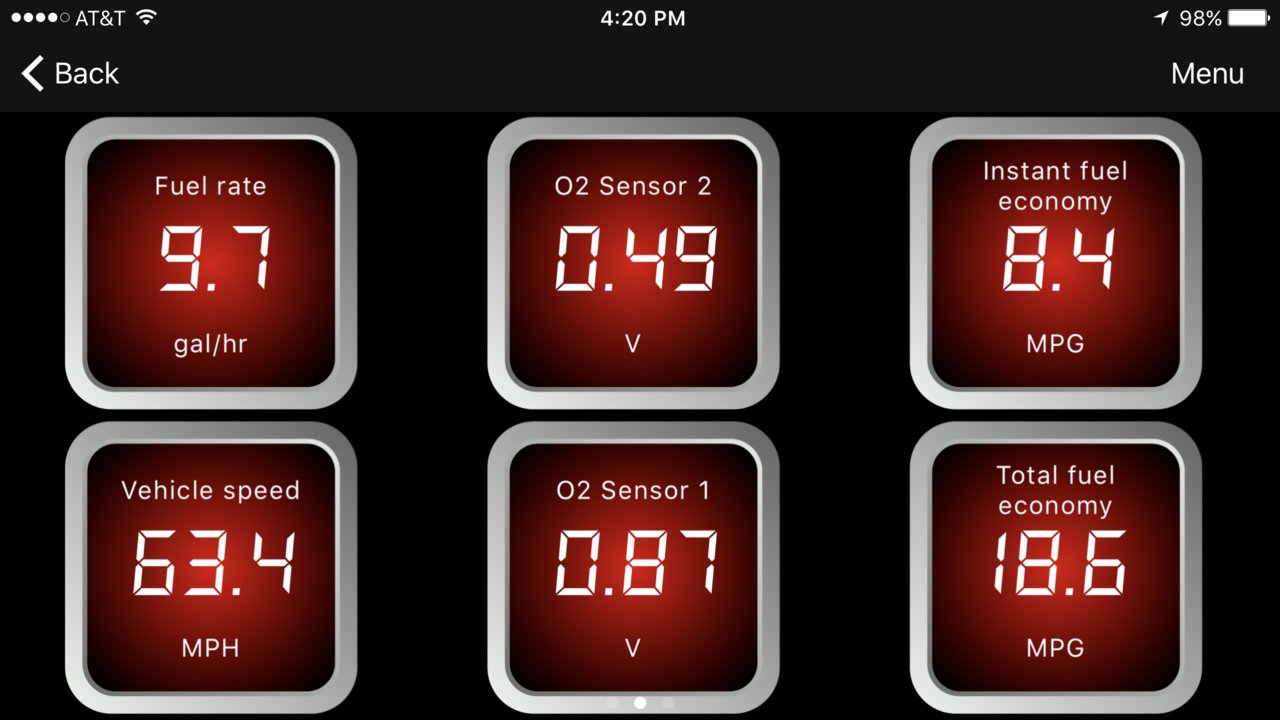

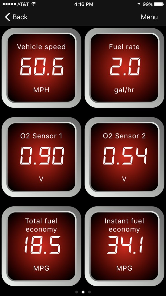

    Just checked mine and in CL it stays consistently between .03 and .9 V. I think we should have similar operation since we are both narrow band o2 and also similar altitude. It looks like yours should be operating somewhat correctly with those voltages as I believe .45 V would be stoich. Is your signal oscillating and uniform or is it favoring a high or low voltage?

    This is a full throttle snapshot14C7D080-1BAD-4DCA-B44E-D7F27877351E.jpg 3793786F-AB7A-4D45-B15D-B82721427F56.jpg and this is just cruising. This was the high side it would go down to .03 or so but constantly fluctuating on o2 sensor 1. O2 sensor 2 highest was in the .50s but it has the mod so would that still have an effect on anything ​
