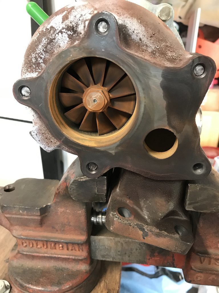

    8DF0C6F8-46E7-4853-8D1D-B7296C5E496F.jpg :annoyed:All but one of the studs broke off in the turbo housing

    you can prolly lay a nut directly over the stud and fill the center with weld and use a wrench to get em out... if you don't have an ease out or something

    Lessen learned there. Antiseize everything during assembly. Epitome of putting the "FU" in Fun.

    That blows!!! Home Depot usually has Easy Out kits.

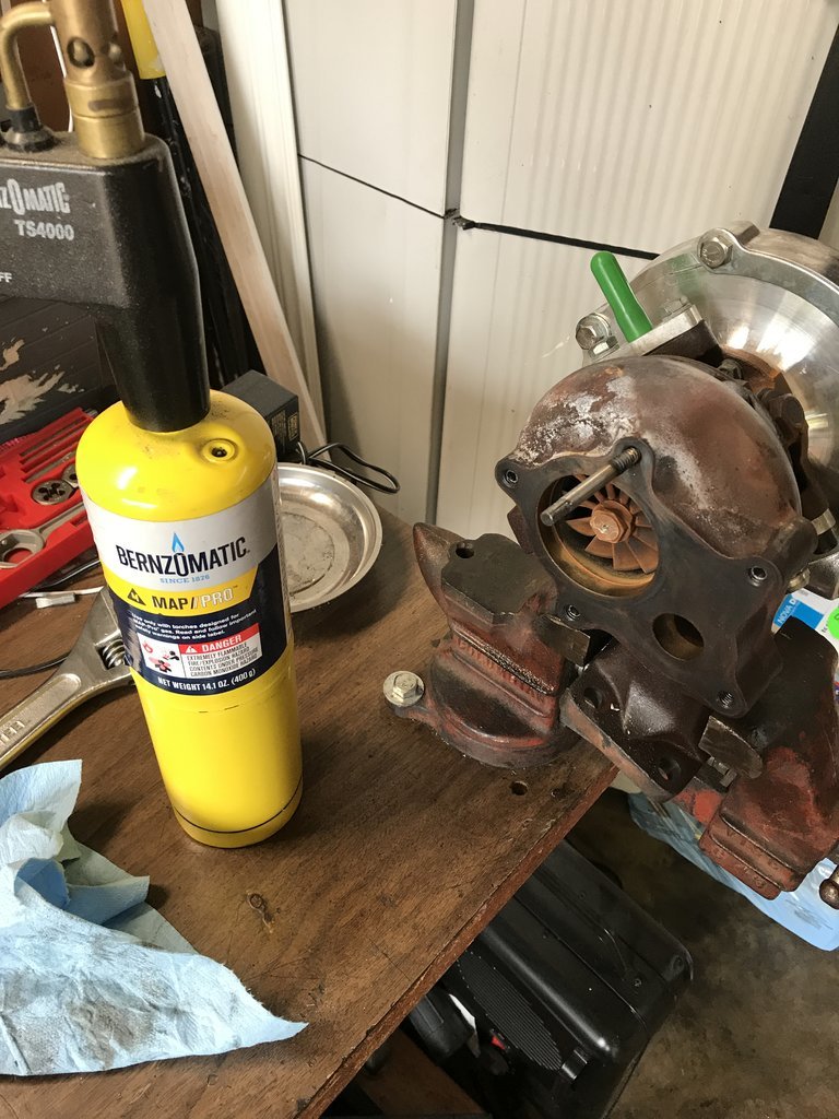

    This is getting worse because now the extractor is stuck on the first one. I may have to break it off and try to get the other ones out with another extractor or drill the other ones out and retread to a different size

    Only thing is there’s thread showing wouldn’t the weld get in the threads the only other thing I can think of is to heat it up with the torch but I’ve already been trying maybe heated up a lot

    what size are those bolts? 3/8"? see if you can find a nut that is small enough to fit down in there and set on the stud like a 3/16" is it is a 3/8" stud, the welding will also heat the threads up and may help it break loose as well as giving you something to hold on to (with a socket or wrench not your hand cuz its gonna be hot)

    Ok extractor is out I’m thinking hellicoil or re thread
    It sounds like a good idea but since I’m pressed for time it looks like I may end up going with helicoil

    Ok so the welding went well. I got the bung welded in and re welded the turbo flange. I went with Helicoil to replace the broken studs because that’s just what I’m familiar with and went well on the first one I’ll finish tomorrow pretty sure C723D4BF-1F2B-4580-B3CF-1631C1901951.jpg
