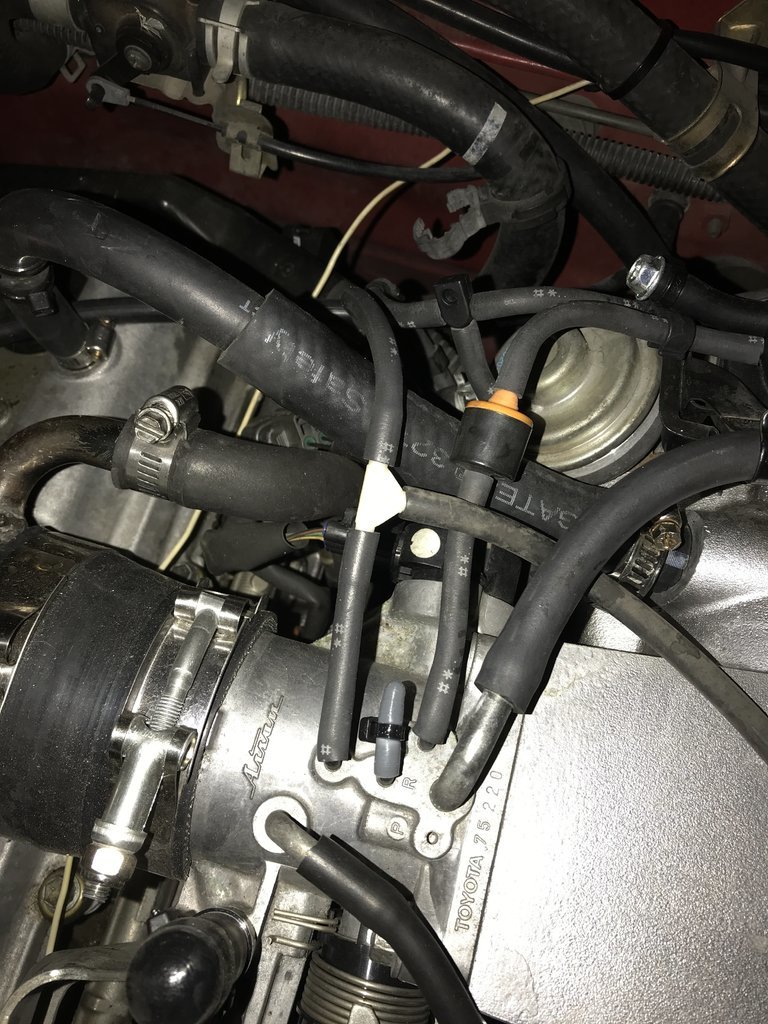

    Jstand
    Jstand Well-Known Member
    Jan 24, 2017
    #208506
    1,125
    Jason
    Irving,Tx
    2011 Tacoma DC TRD SR5 4x4
    No it’s not how would I do that ?
  12. Sep 29, 2017 at 5:41 PM
    #2772
    Jstand
    Jan 24, 2017
    #208506
    1,125
    Jason
    Irving,Tx
    Brice likes this.
  13. Sep 29, 2017 at 5:47 PM
    #2773
    Brice
    Brice Turbo Member
    May 28, 2015
    #156265
    2,304
    Brice
    Texas
    1999 Tacoma PreRunner V6 SR5
    Wastegate assisted turbo delete
    You should be ok then, it is boost referenced and vacuum referenced. The stock fpr is a 1:1 unit and I assume thats the same for the 4-cyl
