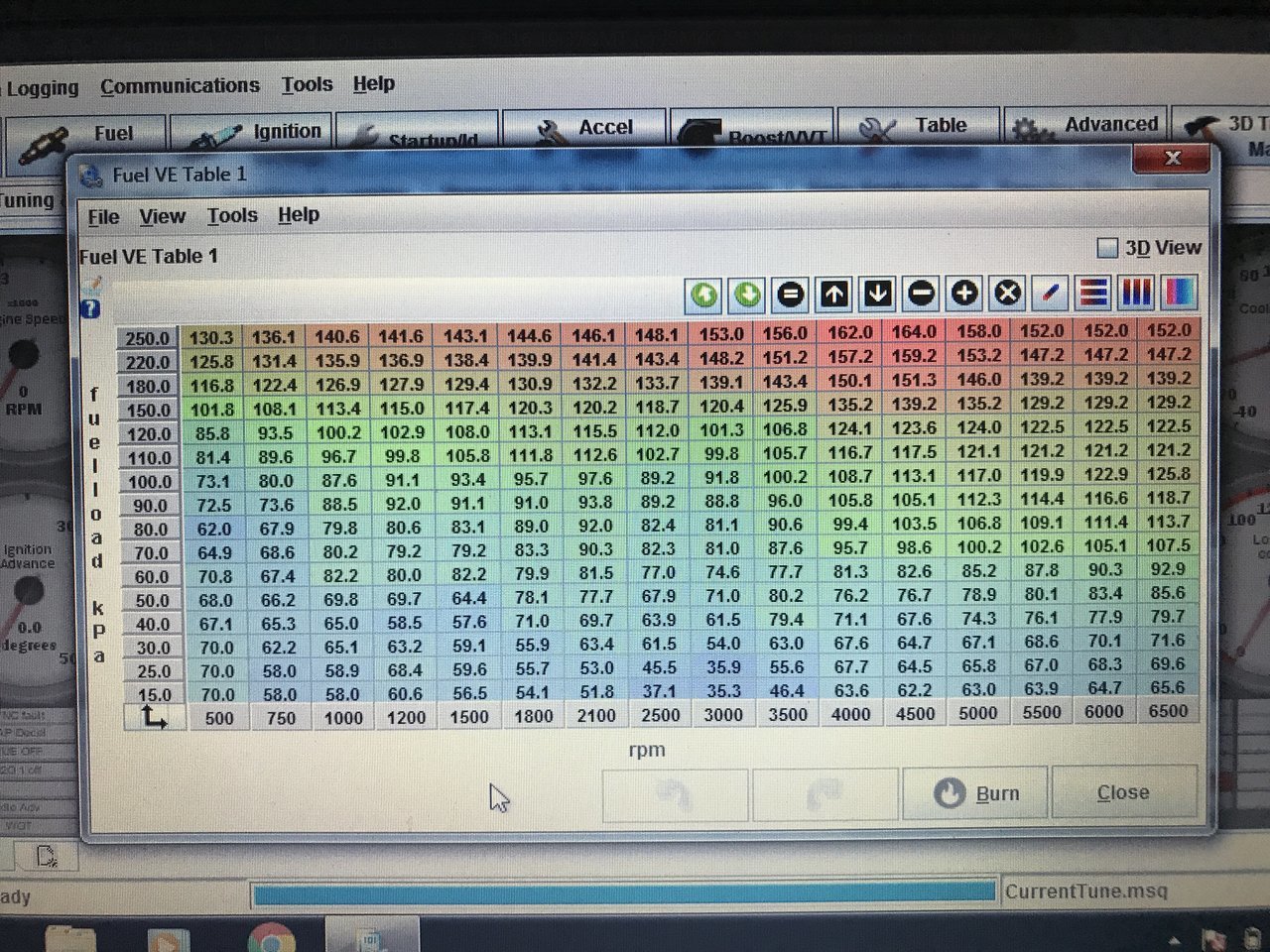

    What do the fuel tables look like in the Haltech software? I haven't used Haltech since E6K days. I'm wondering if I sent you a screen shot of my fuel table if you could key in the numbers to use in the Haltech software. I'm guessing you could probably do that with the timing table regardless of tuning software. The timing table I'm using right nowis pretty awesome.

  14. Oct 1, 2017 at 12:37 PM
    #2814
    Torspd

    Here you go.

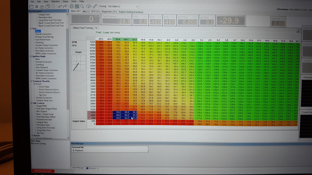

    boostedka
    boostedka Well-Known Member
    Sep 29, 2011
    #64367
    6,042
    James
    NM
    2013 DCSB 6MT, 2004 4runner
    Here's what mine looks like. X and Y axis are flipped. And manifold pressure is in kPa. I'm only using 550 injectors. Does the Haltech have you choose injector scaling?
