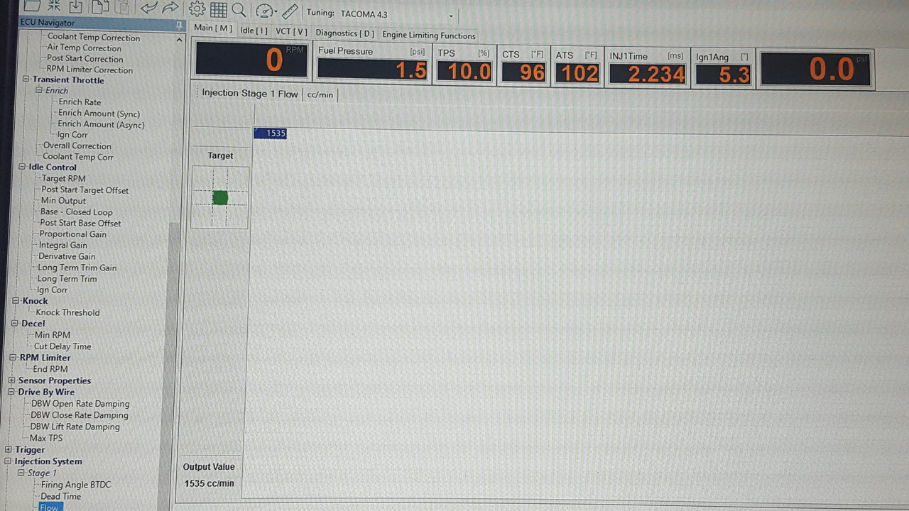

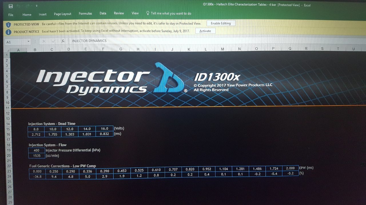

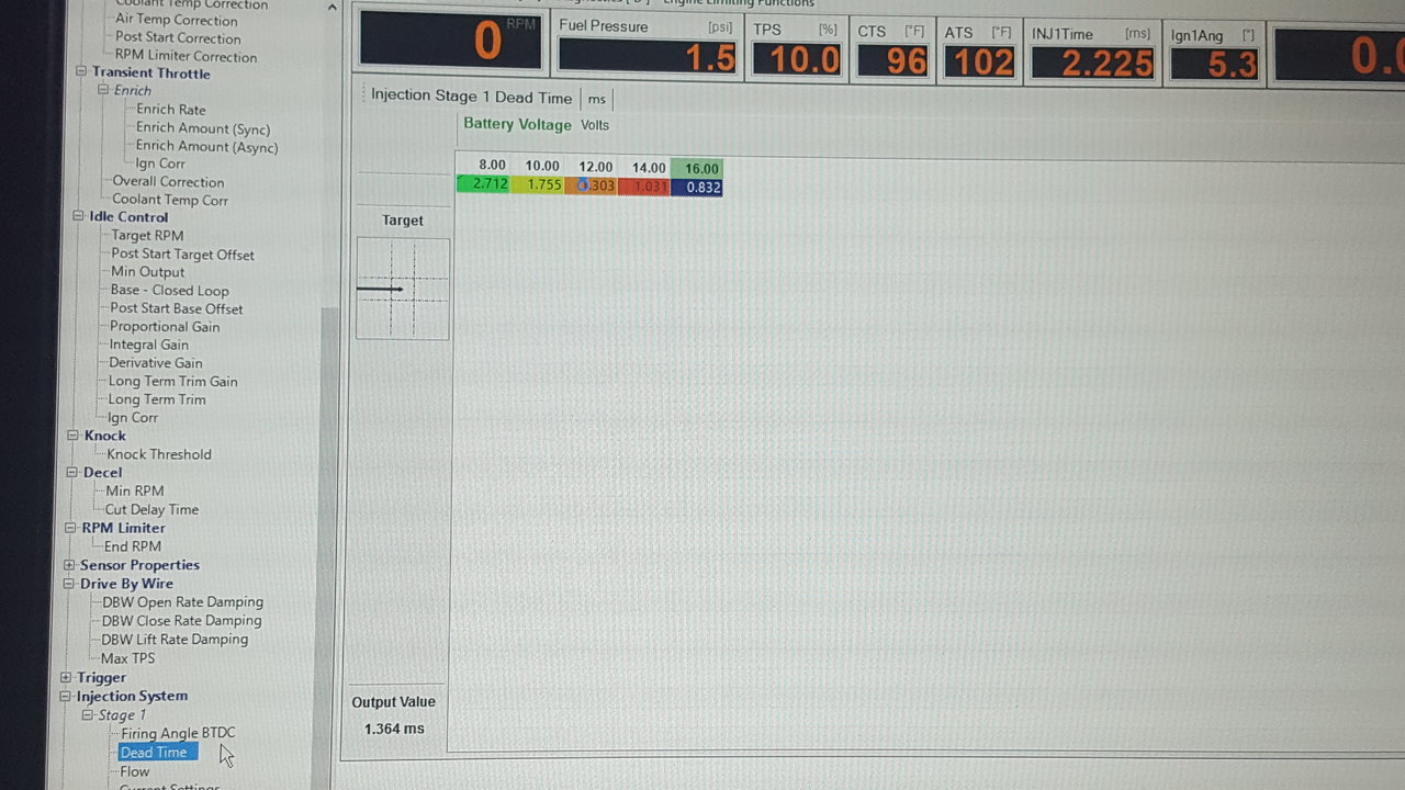

    Content with kPa, or is it not a selectable option?
    Not exactly sure at the moment. Still a little foggy last night.
    I'll just post these up.
    20170904_203331.jpg 20170704_160445.jpg 20170704_160434.jpg 20170704_155228.jpg

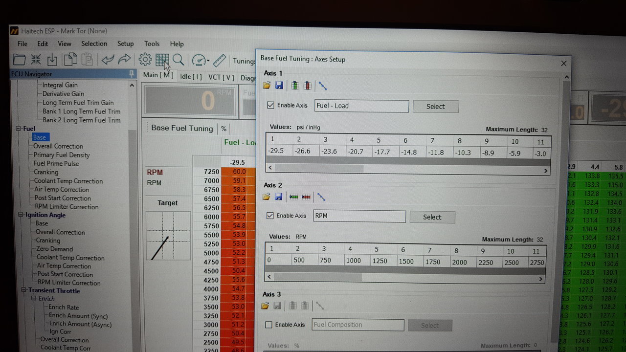

    Super confusing! Is your boost gage in kPa as well? Lol. And is that absolute or gage pressure?

    kPa as it's used in that table is an absolute pressure scale. Roughly speaking 101 kPa is 14.7 psi or what you typically see as 0 on your boost gauge. 30 in-hg is the same as 14.7 psi of vacuum, so 0 on the table is max vacuum. If your table is in-hg/PSI, take the kPa value convert it to PSI and subtract 14.7 to figure out where it lines up with your table.

    It's not too difficult. Like @buyobuyo said, vac is under 100kPa and boost is above. It's like using metric vs standard. Here's a conversion:
    kPa Vac/Boost
    0 29.5
    5 28.1
    10 26.6
    15 25.1
    20 23.6
    25 22.1
    30 20.7
    35 19.2
    40 17.7
    45 16.2
    50 14.8
    55 13.3
    60 11.8
    65 10.3
    70 8.9
    75 7.4
    80 5.9
    85 4.4
    90 3.0
    95 1.5
    100 0.0
    105 0.7
    110 1.5
    115 2.2
    120 2.9
    125 3.6
    130 4.4
    135 5.1
    140 5.8
    145 6.5
    150 7.3
    155 8.0
    160 8.7
    165 9.4
    170 10.2
    175 10.9
    180 11.6
    185 12.3
    190 13.1
    195 13.8
    200 14.5
    205 15.2
    210 16.0
    215 16.7
    220 17.4
    225 18.1
    230 18.9
    235 19.6
    240 20.3
    245 21.0
    250 21.8

    @boostedka What do the numbers in the cells represent? Are those the stock pulse widths? And why did you choose such a high upper bracket? Unless your software can interpolate you're going to be leaving a lot of precision on the table.

    This way it gives me room to up the boost later on as much as the truck grows (like building the motor in a few years) and already have a decent fuel table in place. I could get more exact with my current boost levels by lowering the top end amount of boost and be able to tune every 0.5psi, but the practical difference it would make in my AFR's wouldn't be insignificant.
