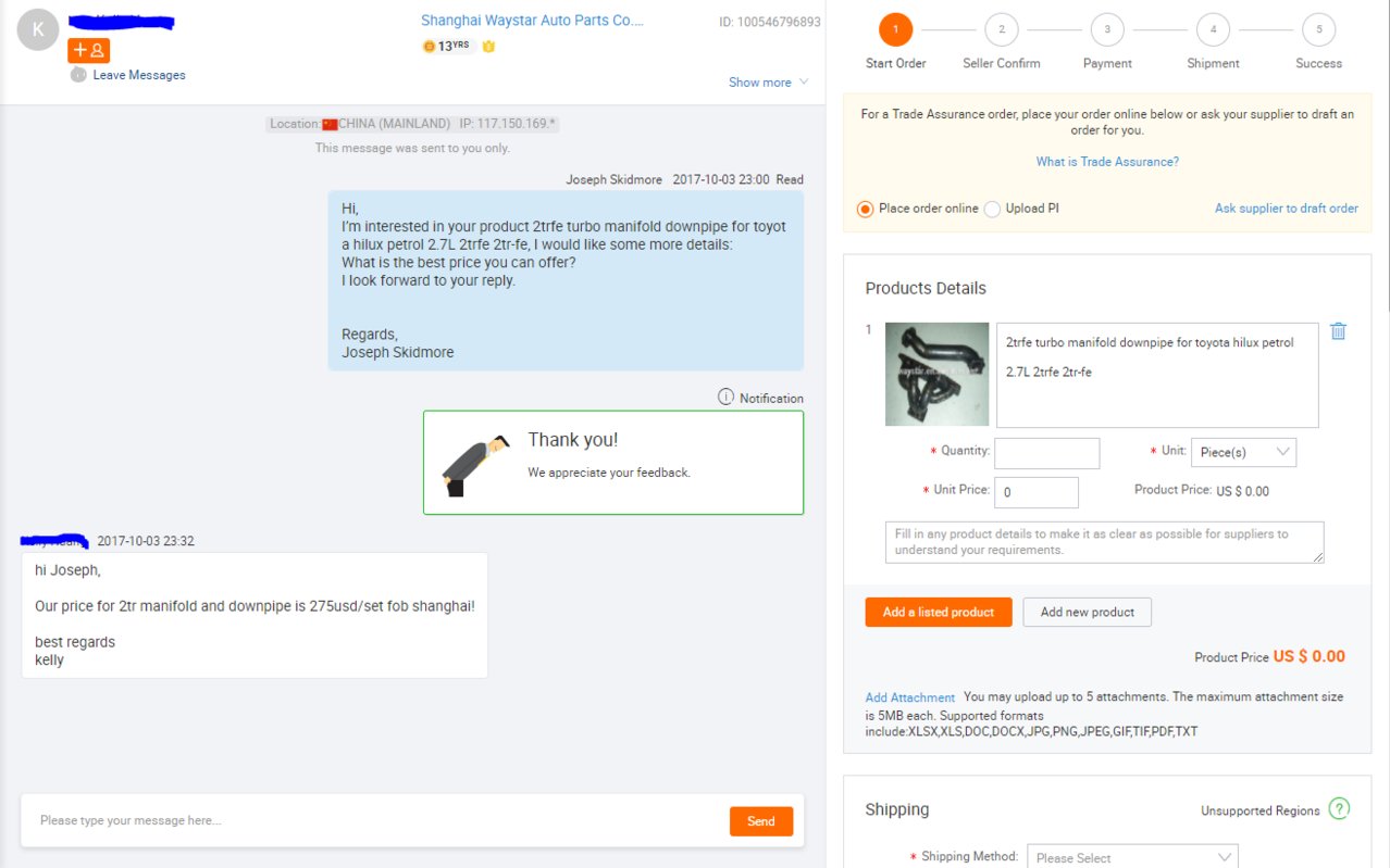

    SO I received communication back regarding the 2TR manifold & DP set (directly from the manufacturer that OzBoost uses) that the set is $275 USD plus shipping, which even if it were $100 to ship, it's still cheaper than going through OzBoost. Last quote I got from OzBoost was $450 for the manifold and $150 for the DP plus shipping! I've attached the screenshot of the communication, because I'll probably pull the trigger on this next week! Hope this info can help people considering adding some 'Murica to their 2.7!
    Also, my message to them is a generic price inquiry- the Engrish is second-to-none on Alibaba sometimes hahaha

    is that made for a t4 turbo and does it have a spot for a wastegate or was it designed for a turbo withan internal WG? I cant remember. that's a fantastic deal.

    I know the OzBoost kit uses a T28 flange turbo that's internally gated. Once I order and receive the manifold and DP, I'll decide what turbo to go with and weld new flanges if need be. I kinda want to go external gate, just to be more annoying lol.
