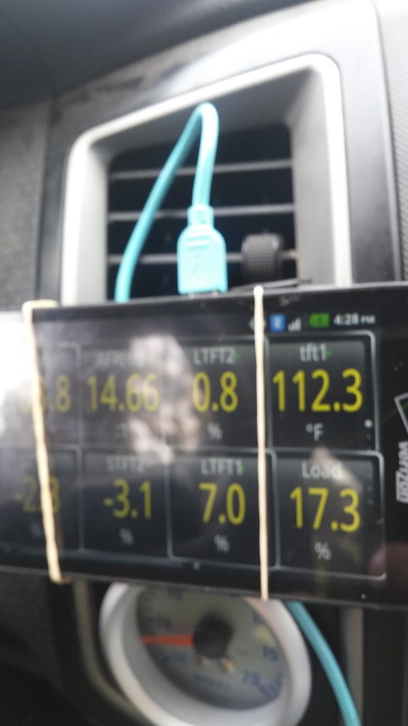

    Bw s256 turbo with 3 in glass pack dumped pre axle raptor liner bed and top rails and fenderflares and rocker panels. Hunter side steps. Plasti-dipped upper fenders and emblems. satin black spray paint here and there inside and out. 5100's set to 1.75" up front . C channel front bumper. Maxxis bighorn 255/85/16

    Put 12... More gal of e85 in her today (had a $25 gift card) and it seemed like the ltft were a little lean (10% ish) during my ~40mph driving but the ~55mph cruise was perfect but stft looked good for the most part along with afrs and i did another boost pull to ~4psi just "eased into it" like just more than half throttle and it pulled super smooth, no stumbly hiccup or anything. Im hooked and ready to finish and i think this weekend was just the motivation i needed
    well I have a pending p2198 rich bank 2 sensor 1 which doesn't make a lot of since my fuel trims if anything over the last 60 miles have been a touch lean, or is this because of that and it is over correcting? (I'm pretty much now on 100% e85 and had tuned on like a 5:1 ish ratio of e85 so that's why its slightly leaner)
