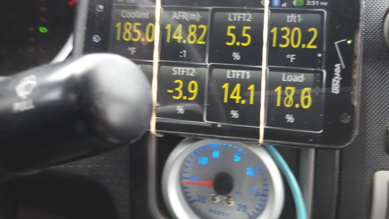

    Which fuel trims are lean? Long term or short term? If your AFR sensor is reading rich, your trims will pull negative (lean) to correct.
    Which table have you been editing when you're tuning?

    I have just been in the fuel table (f4) my long term fuel trims have been like 5 ish and 10 ish (positive/lean) short term have been for the most part +- 3-4 under cruise. They change a bit more dramatically during acceleration and coasting

    Ah okay. That's odd that it's reporting a rich code since your trims are positive. Can you clear the code? Does it come back?

    yeah I can. it was flagged yellow and just said pending, the other two codes I have are red (down stream o2 sensors) I don't think it by itself would throw a cel but I'm not sure.

    I may have a vacuum leak somewhere because when im at a light even after it warms up it has some 400-600 rpm fluttery stuff from time to time20171010_155139.jpg

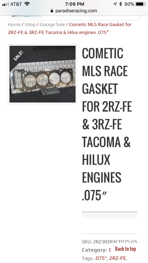

    Would a cometic gasket drop my compression ratio at all allowing for a tad more boost on stock internals?

    depends on the gasket thickness you get. usually they have varying options

    not sure what stock is. but it wont be enough of a change to crank up boost more anyways.
