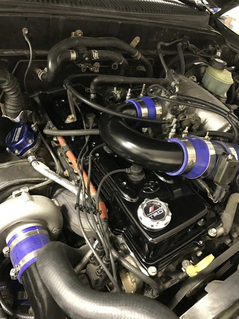

    My MAF is basically right on top of the Valve cover before the piping makes a 180* turn into the TB.

    Thats about where mine is and I've had no issues either. When the BOV opens, you will measure the charged air in that small curved section. It won't be much so you won't go too rich. If you move the BOV to between the TB and MAF, when the BOV opens, all the extra air in the charge pipe starting from the turbo will be measured and you will go much richer. Stalling is pretty rare but I think someone here had issues with his truck stalling after a power pull.
