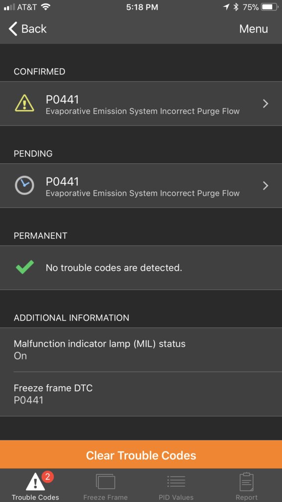

    Unfortunately I’m still having trouble. It’s not very consistent. I can go through first second and third gear and AFR’s are good 12.3-12.8 and running strong and then five minutes later do it again and it has hesitation and AFRs go lean 14.5-15.5 I can’t figure out what’s causing this intermittent problem

    I got this code today but not sure this would cause my issue6FA0E801-A48D-4CFC-B74E-D6B8888D1CC0.jpg

    I replaced my evap sensor and it fixed that code @Jstand
