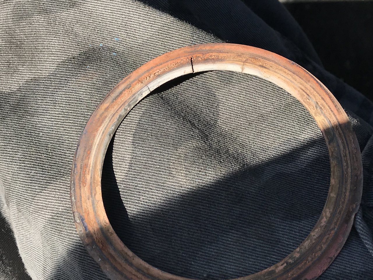

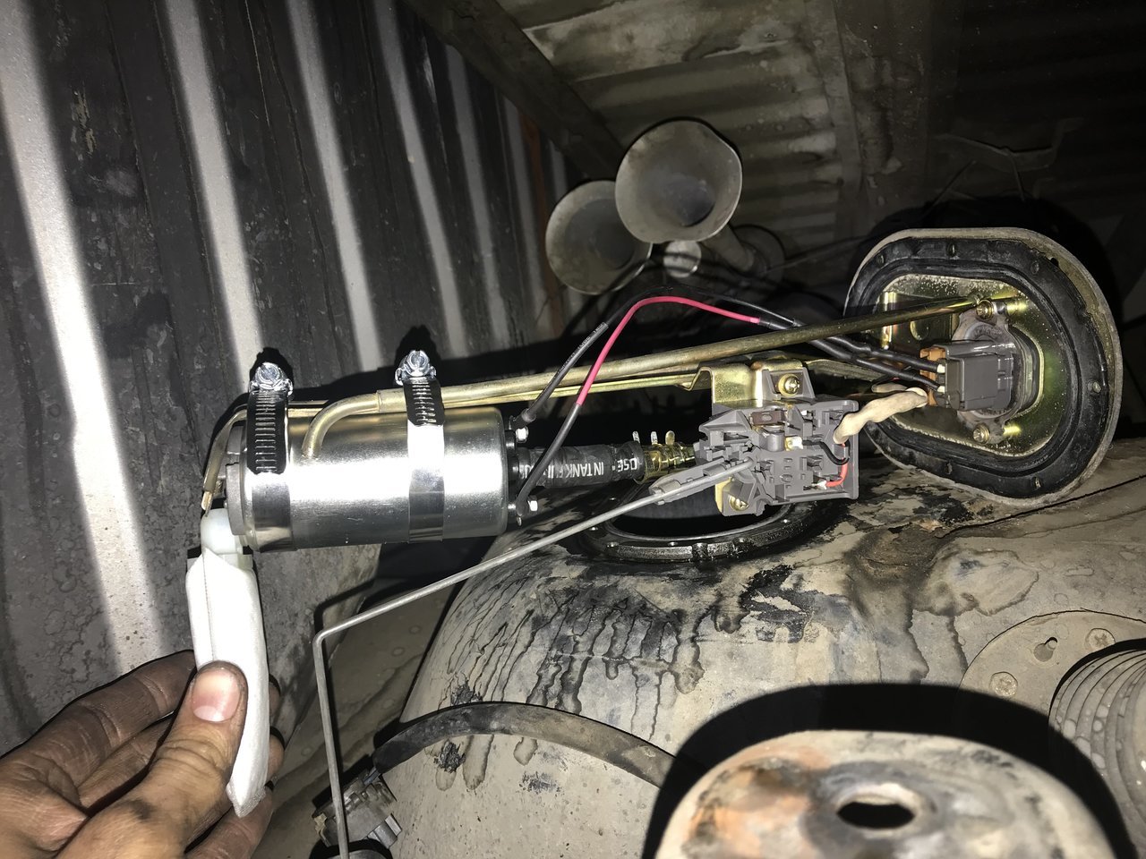

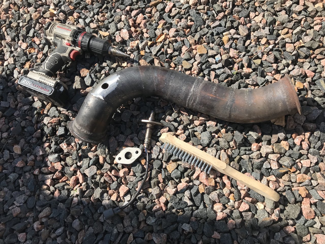

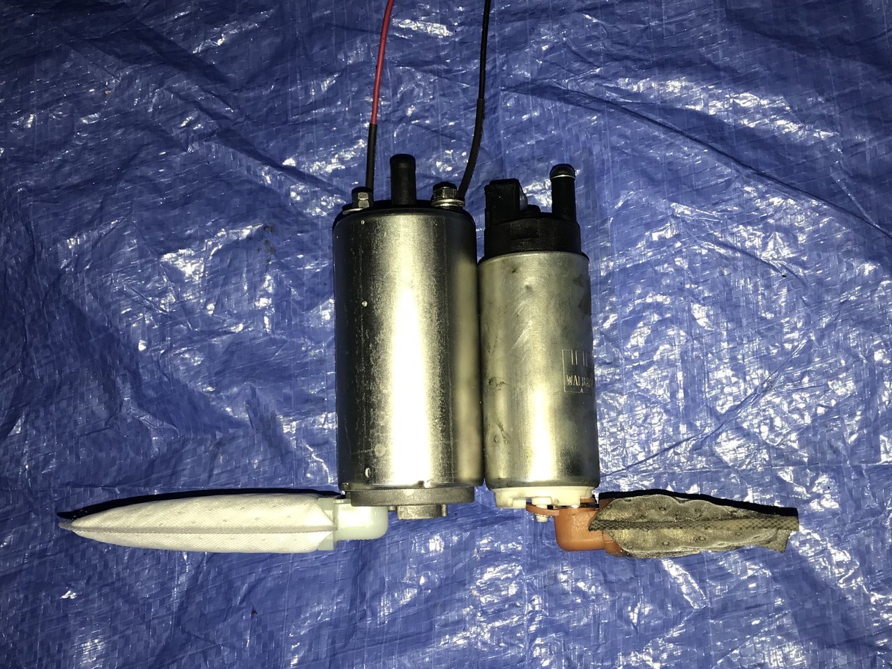

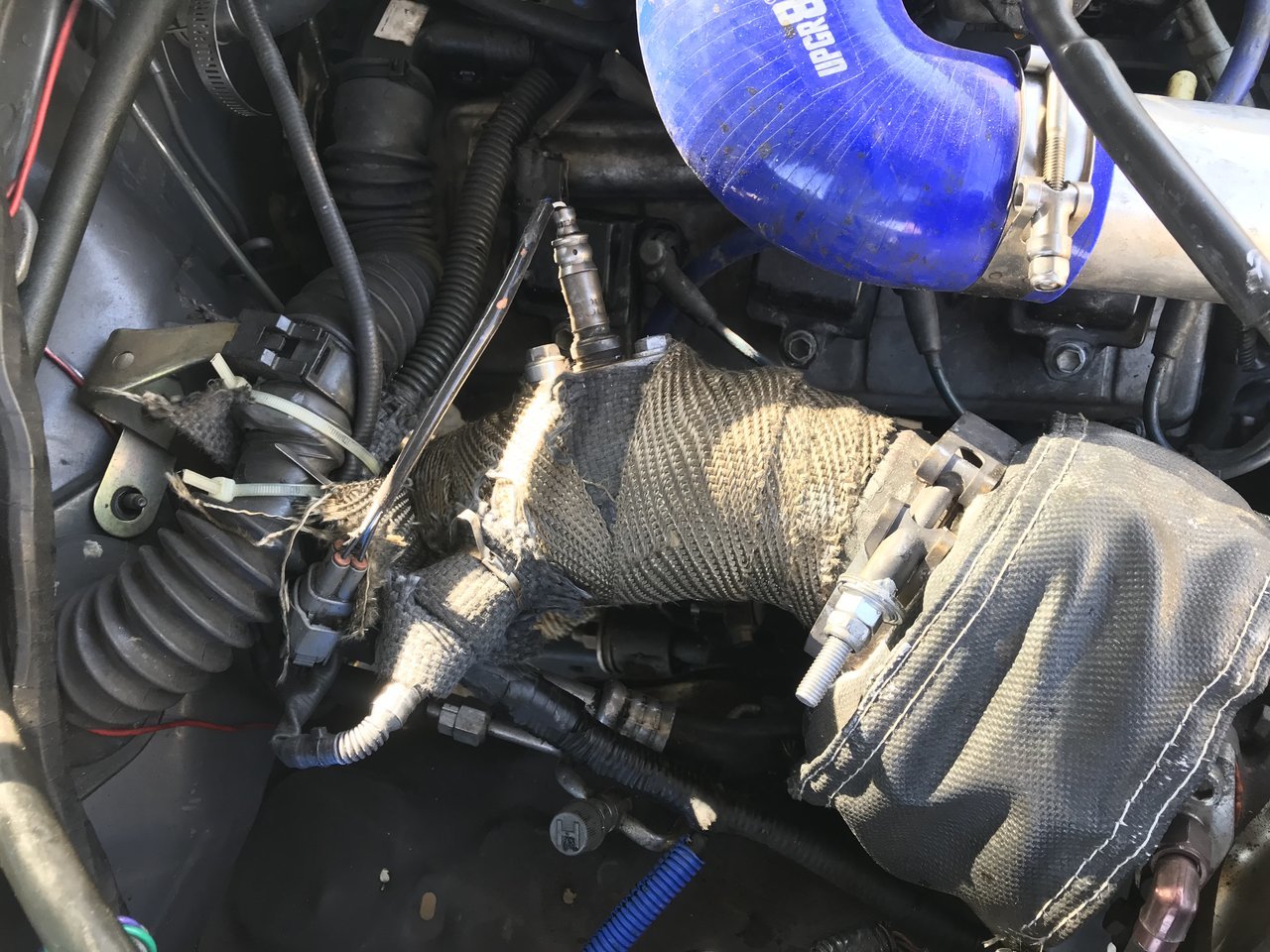

    Ok dudes, so I’ve had an exhaust leak on the driver side and I’ve been wanting to relocate my front o2 sensor closer to the turbo.
    The far away o2 was causing lean running and the crappy ring metal gaskets that come with the CX racing kit were causing the exhaust leak (developed lots of little cracks).
    Also my 2 year old Walbro 255LPH fuel pump already started to go out (lately my truck would intermittently take 10-20 seconds to start), so I threw a bigger TT Supra 280LPH pump in there.
    Runnin WAY better now!
