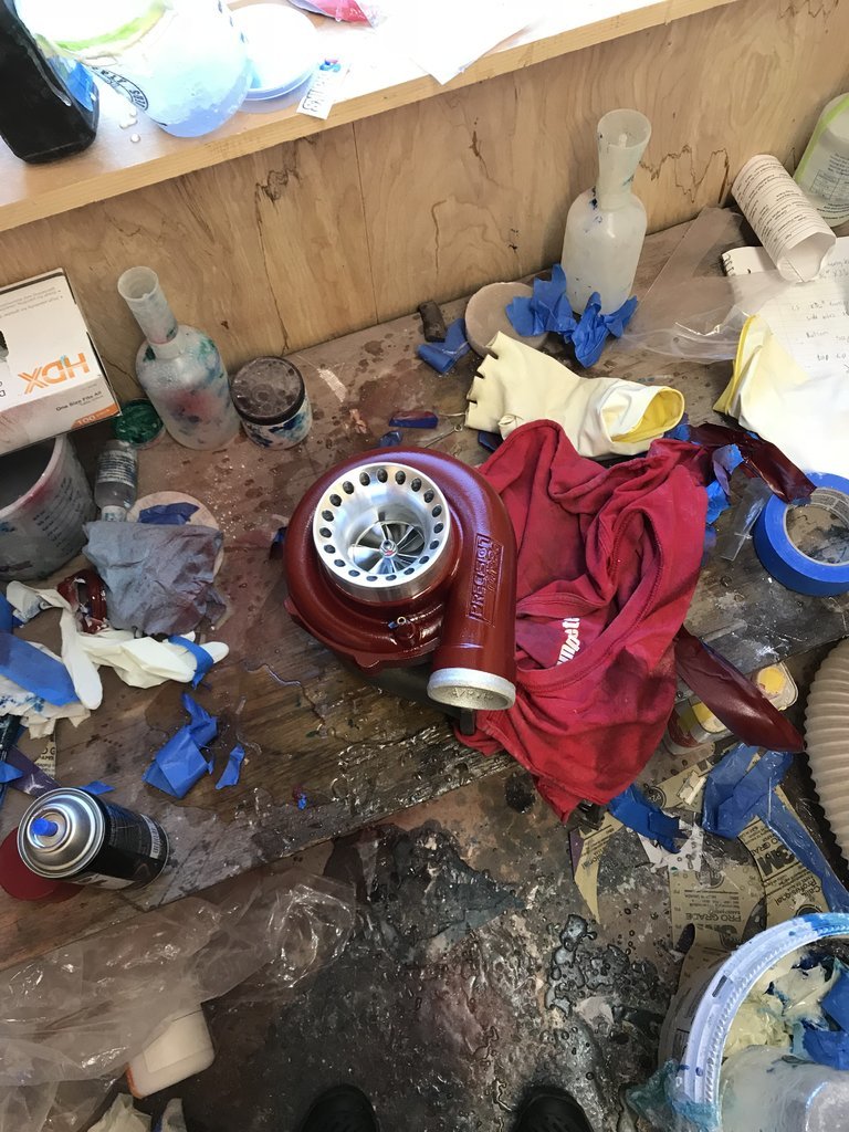

    Pretty billet under there. What size turbo?

    3RZ 04 4x4 black ext cab
    2.5" lift king/total chaos Skids sliders rear tire swing
    The tag says 58/58? I got what Luis recommended. But not exactly positive because there’s a casting on the exhaust part that says 68

    CA
    99 turbo 5 lug long travel
    Kinda stock
    Nice that will be fun. Bb or journal?

    That sucker can make 400hp pump gas
    Luis said with my fuel mods this turbo could make around 700 for a 3rz most but without building my motor or trans swap I’ll keep it around 300ish for now

    Heck yeah. Engine would need love for 700.
