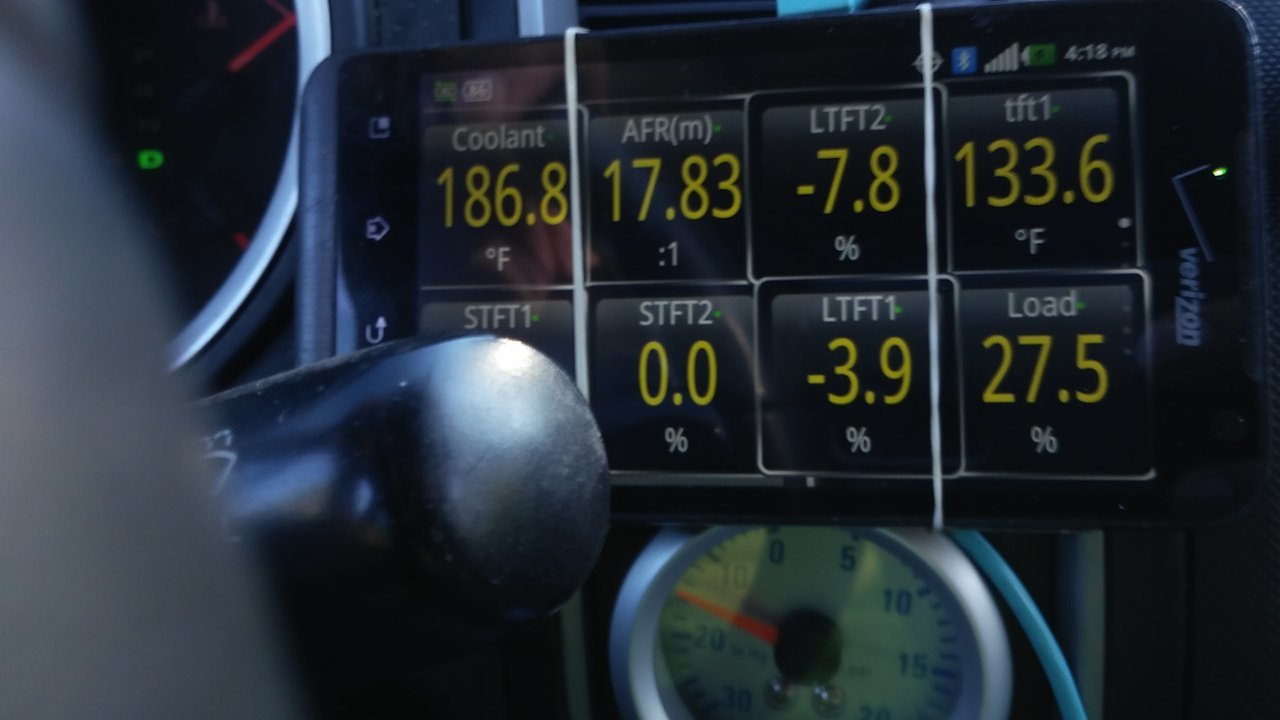

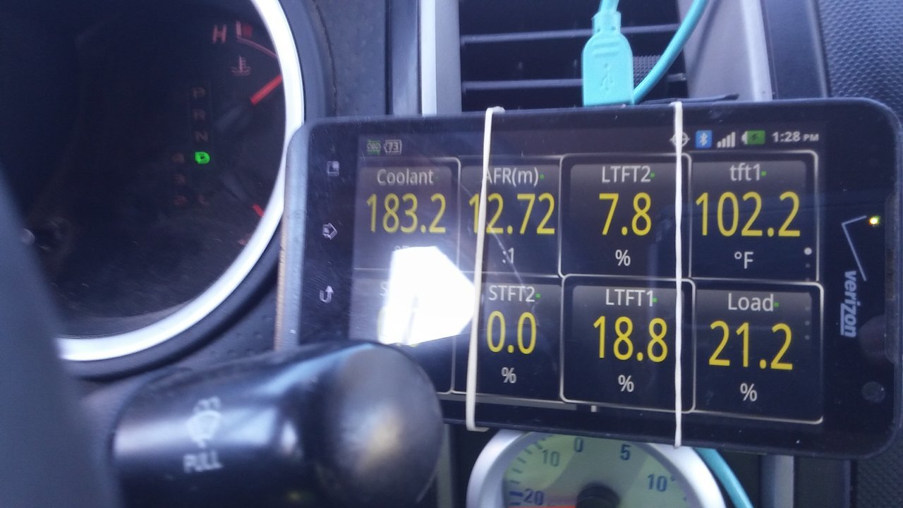

    I went through and bumped my fuel table up in my light cruise area since its been just a touch lean after about a full tank of e85 now. Any idea why my stft are dead nuts 0 and ltft are pretty lean still?
    20171018_132837.jpg 20171018_132831.jpg and afrs are ??? Where ever they want when ever they want i guess

    If the long term is lean, and the short term is 0, then its done all the adjusting it needs to, and is running off the set long term value. You are overall lean still. Bump that fuel up!

    @yota243 You want the sum of ST and LT trims to be 0. If you have a large LT you need to add fuel until your ST is the same magnitude but negative. I.e. way more fuel.

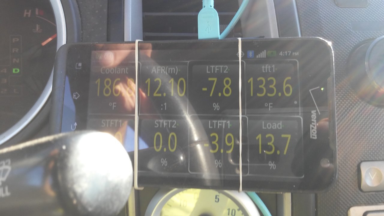

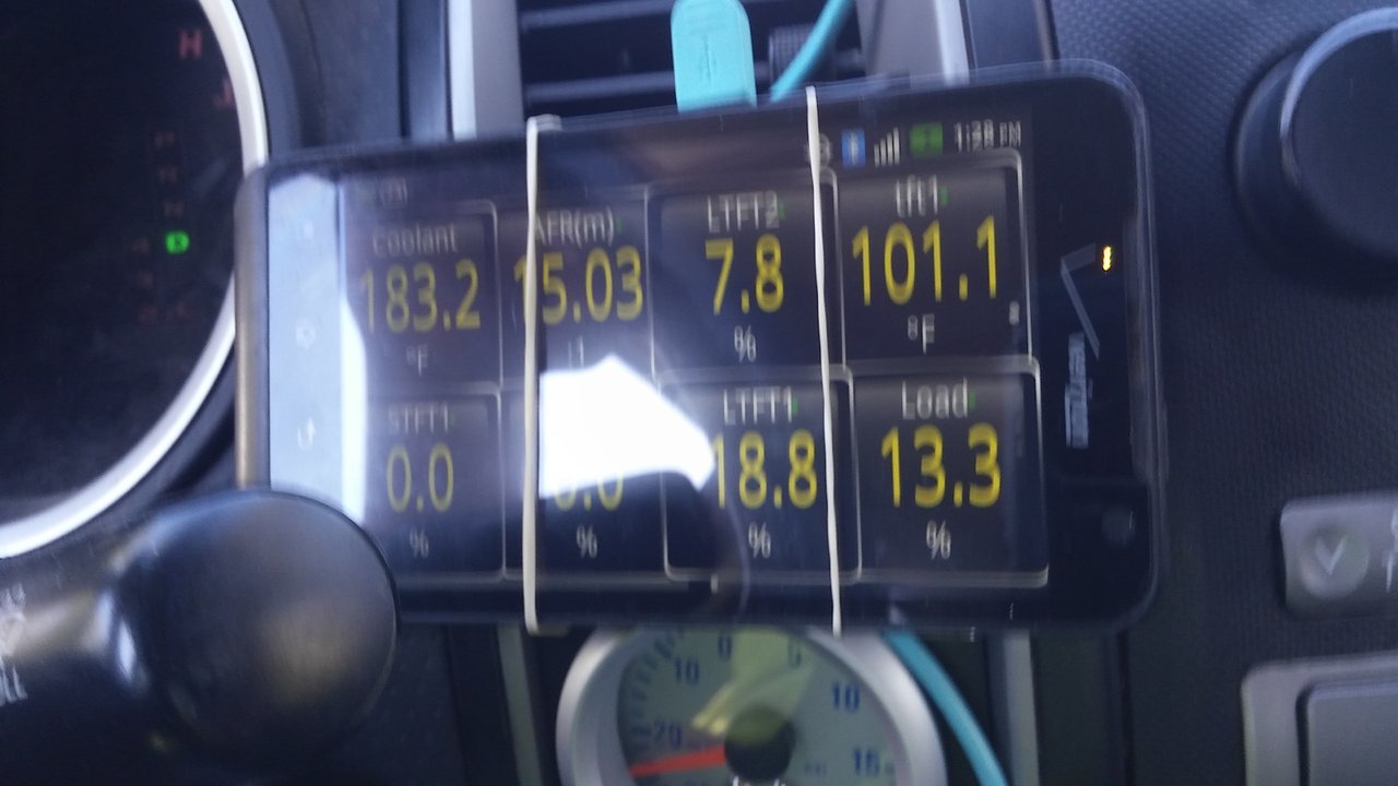

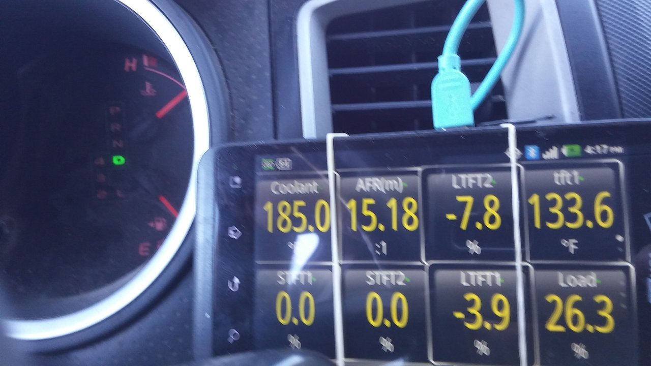

    Ok so i added more fuel and got my trims better but my afrs are goin kinda crazy now. Is it just getting use to the changes? Or do i need to change something?

    Does your afr clean up better driving slowly?

    It seemed like it was rich below 20 inhg and above 10inhg maybe and anything in between dang near topped out

    All of those pics were right around 40 mph btw

    Hmm well ltft are moving correctly. Not sure if I want to trust your afr gauge.
