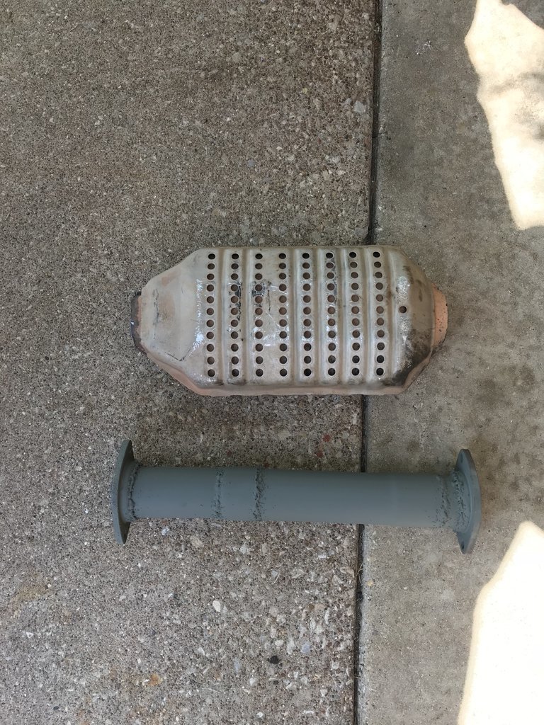

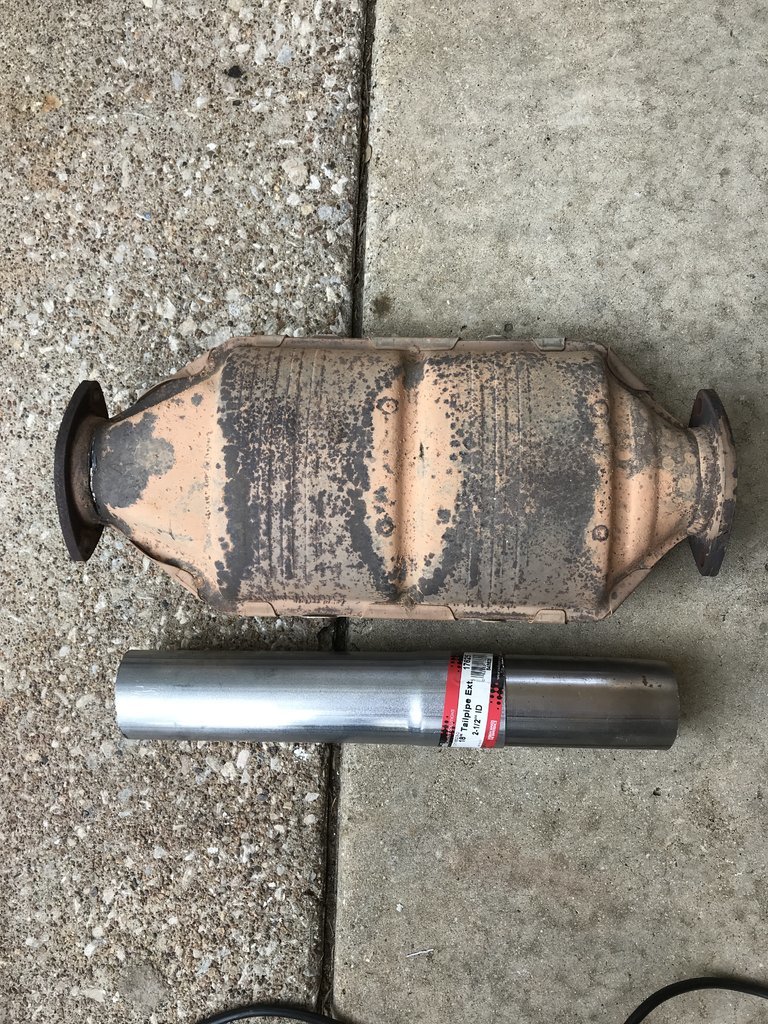

    56FF9368-E897-4779-9755-0E113B7E18B3.jpg 8898DF9A-0368-461C-A8AA-DFC5CBEA7F69.jpg I guess you would call this a cat delete :D
