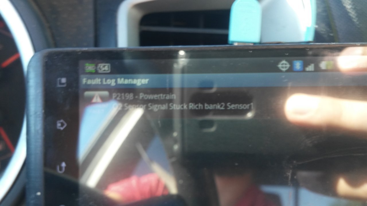

    Ummm well my Pending cels went away and i cleared my "o2 sensor stuck rich" and my afrs seem to have straightened out, so that's something, but not very exciting.

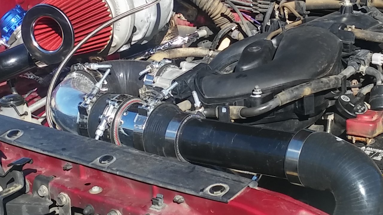

    And the code is back and i have lean spikes again. Is my sensor going bad?
    20171031_102742.jpg drives pretty normal (afrs and fuel trims and actually driving) when code is off. When it is on afrs go nutz fuel trims go rich and there are several places where it has like a miss fire (afrs maxed out 18.15+)

    Post a picture of your intake tubing again. The section which has the MAF sensor in it.

    Best pic i have on my phone
    Screenshot_2017-10-31-11-55-33.jpg its the step up from 2.5 to 3". Would something there make my o2 sensors funky?

    Torspd Custom Turbo kit [] Borg Warner 9180EFR Turbo [] Haltech Elite 2500 [] TiAL Q BOV [] TiAL V44 Wastegate @ 15psi [] CP Pistons [] CP Carrillo Rods [] ARP Head studs [] ARP Main Studs [] ARP Header - Head Studs [] Ported Heads w/ 1mm oversized valves intake/exhaust [] Brian Crower Forged Stroker Crank [] Darton M.I.D. Sleeved Block [] Kelford Camshafts [] Torspd 160* T-stat mod [] APR Large Fuel Rail [] Walbro 460 LPH E85 Fuel Pump [] FueLab FPR [] APR T56 Conversion Kit [] KP RACING Built T56 [] McLeod Racing Custom Twin Disk Clutch [] One Piece Aluminum Driveshaft [] MGW Shifter [] Custom lowering kit [] Ohlins Front Coilovers [] QA1rear shocks [] Custom Ron Davis Radiator [] Dual SPAL Electric Fans []
    Does it have a flow straightener?
    Is the MAF in the metal section just before the bend, or in the plastic?
    If no straightener, then loose the clamps, and clock it a few degrees in up. Reclamp, and test drive. Keep doing this until you find the smoothest MAF reading. Translated into better short term trims.

    Yeah that straight "chrome" section before the last 180°. Ill clock it up some and see if it helps thanks
