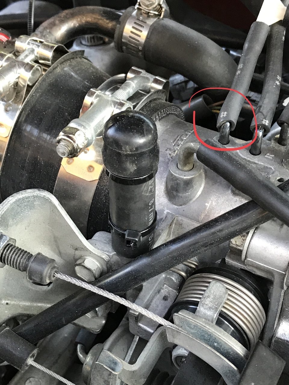

    Are you running a vac/boost line to your FPR?

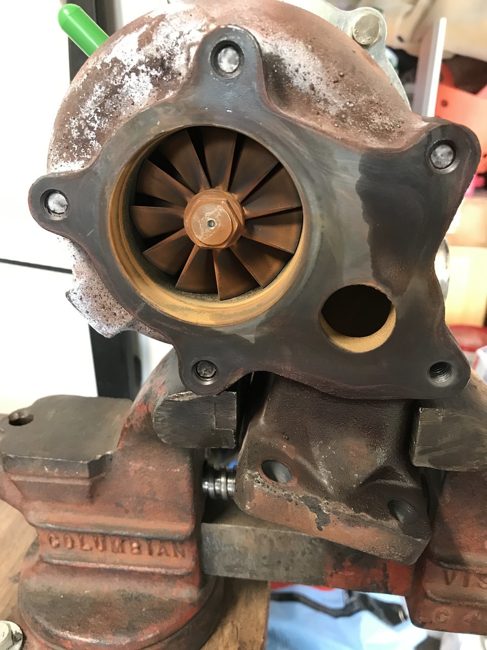

    The line from the FPR is t’ed into one of the three metal vacuum tubes coming from the top of the TB. It’s the one closest to the TB opening.B4101C50-1BE3-4E7B-81E9-9B2E5330C776.jpg And I used mild steel on the down pipe if that’s what you mean but here is a pic of the turbo when I took it off to re weld I don’t know why it’s so rusty inside EED4DBF1-9A68-4E52-BCC9-FD985E9B727E.jpg

    Cast iron housing. Combined with heat, and the mild steel down pipe, it will rust with a quickness.
