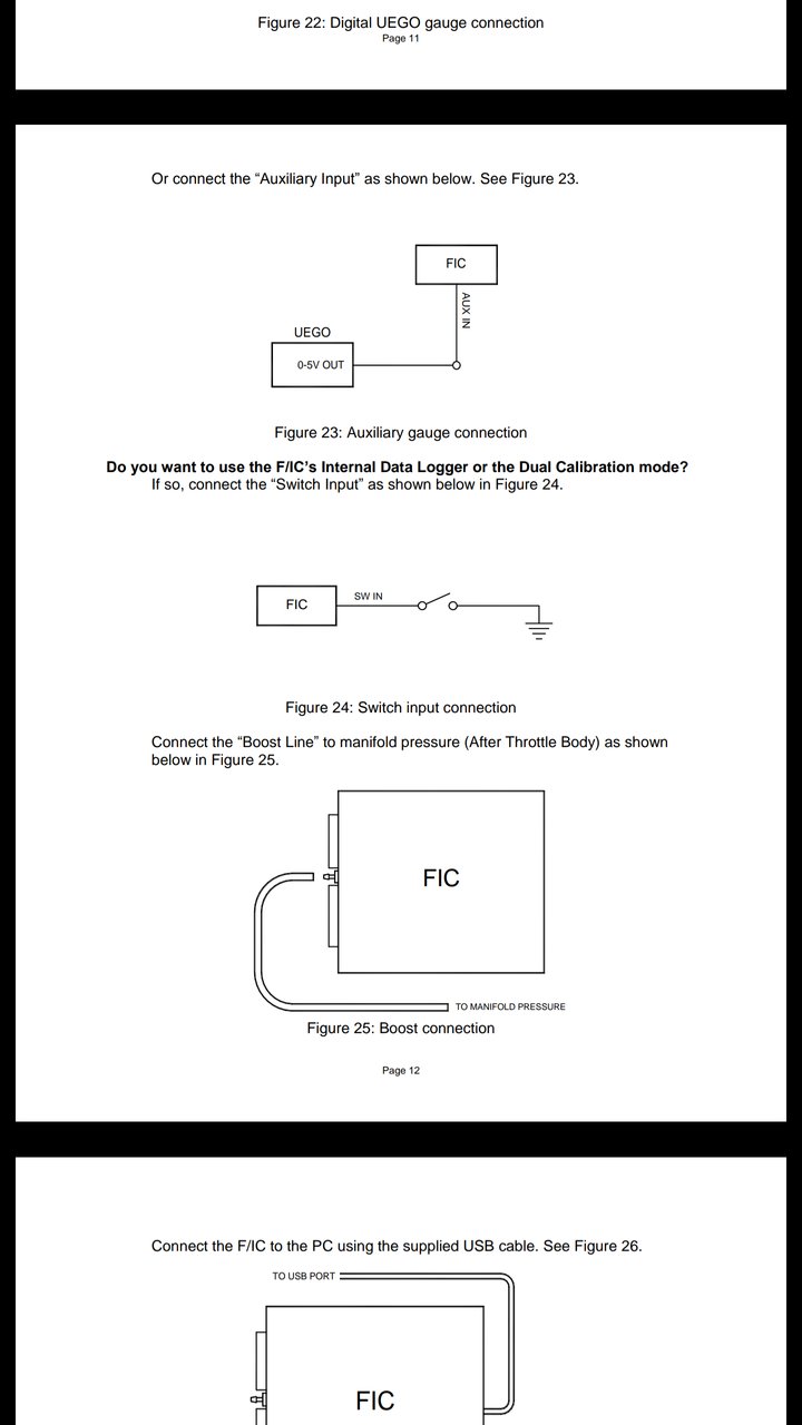

    The FIC-6 does in fact support 2 maps (dual calibration). This is achieved by the SW IN wire (white) on the harness.
