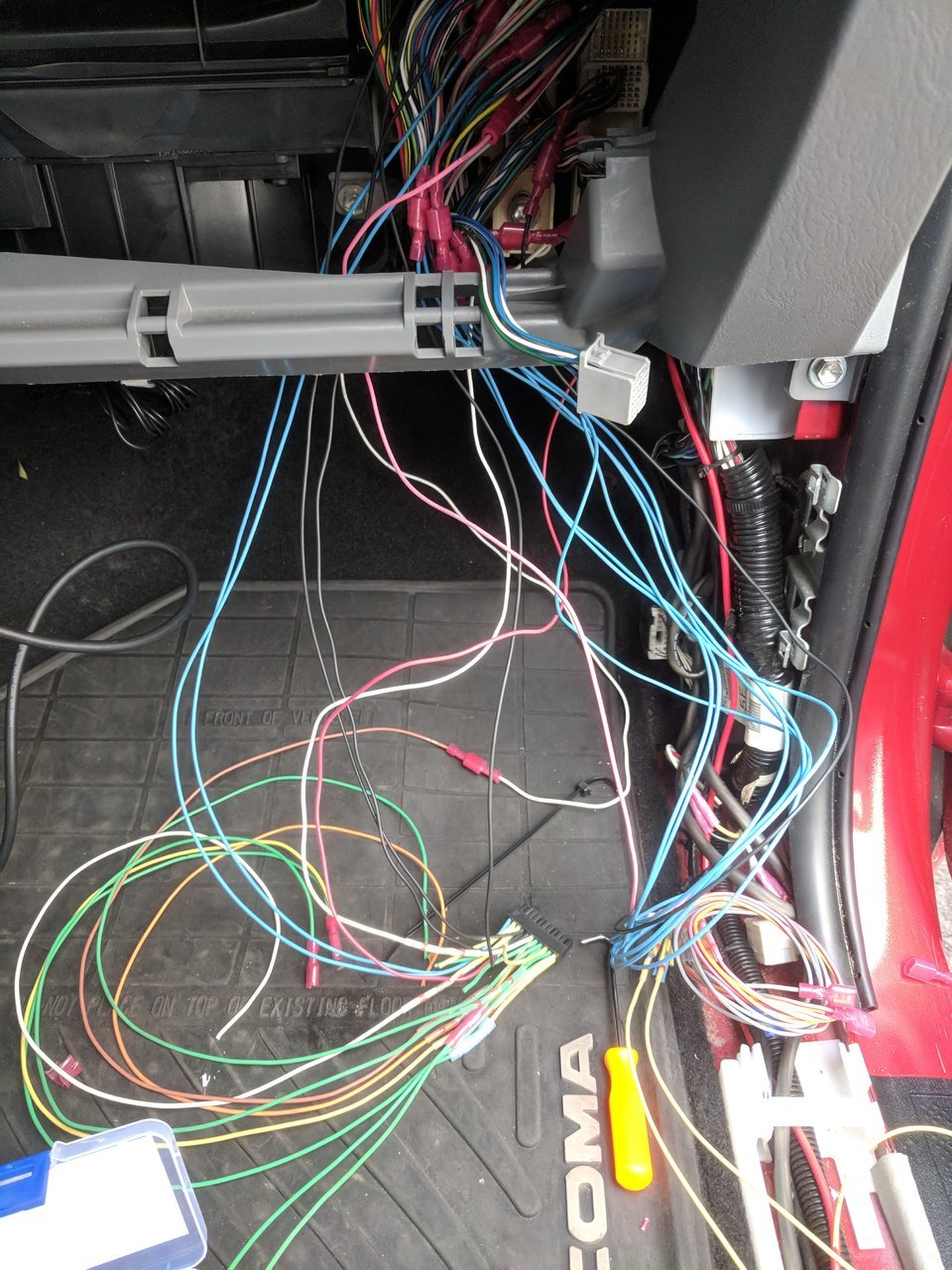

    Well here goes nothing! Got off work a little early so I decided to say fuck it, and attempt the FIC-6 wiring. Wish me luck!

    Anyone have any insight on this? The diagram doesn't match the description of which wires get the resistor. I'm not sure if the Haltech or MAP-ECU3 wiring would have similar connections, so it's worth a shot!
    Cam Sensor Resistor: (Updated 8/18/15)
    Toyota has a reputation of getting by with a very dirty signal with their sensor circuits, it could be to save cost or just because they can. Regardless to the reason because of this we need to add a low pass filter otherwise when we hook up the AEM the dirtiness (excuse my lack of knowledge on this I am not an EE lol) of the signals will be amplified and the truck will throw a code. Luckily this LPF can be simply taken care of by a 1/4W 2.2k resistor. You will need to bridge the CAM MAGO - and the CAM MAGI + with this resistor.
    (Diagram Courtesy of Garret Curry)

    Good luck!
    I’m interested in wire lengths.
    You should definitely do a 2TR-FE F/IC-6 writeup.

    Well the truck starts and idles, albeit a little rough, but that probably has to do with me not having the onboard MAP sensor hooked up just yet (need longer vacuum line). I currently don't have a CEL for cam signal, nor do I have a resistor in the negative cam signal wires. Started on z.110 firmware, idled rough as hell, then switched to z.107 which cleaned up a bit, but still has what feels like a stutter or miss. I'll hook up the MAP sensor tomorrow and continue troubleshooting.
    As a side note, whenever I first start up after disconnecting the battery, it idles extremely low and rough for a while. So it could also be the ECU re-learn process.

    My truck does that as well. It did it before I installed the map-ECU3, so I chalk it up to the ECU relearn.

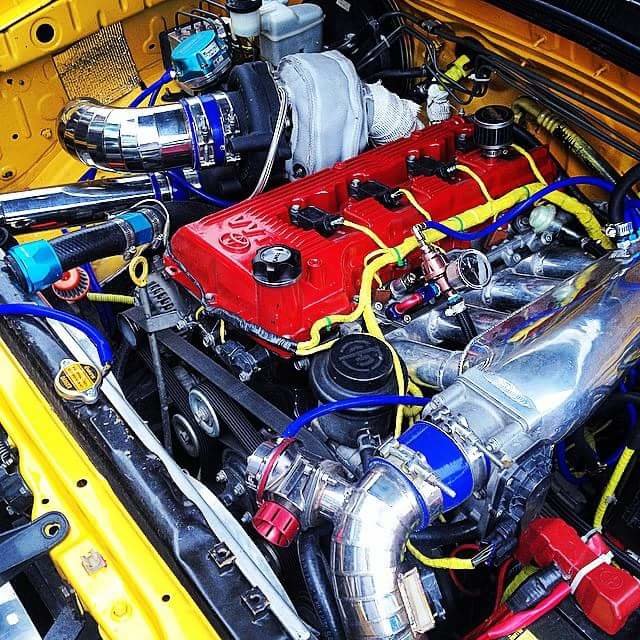

    Just looks so right.... :drool:

    I want a forward facing intake manifold:thumbsup:

    X2 on that intake manifold.

    Who's truck?

    Friend from Thailand. They have been doing it for while now, but we will do it better

    Those Thai guys don't wait around.
