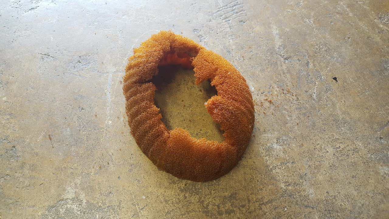

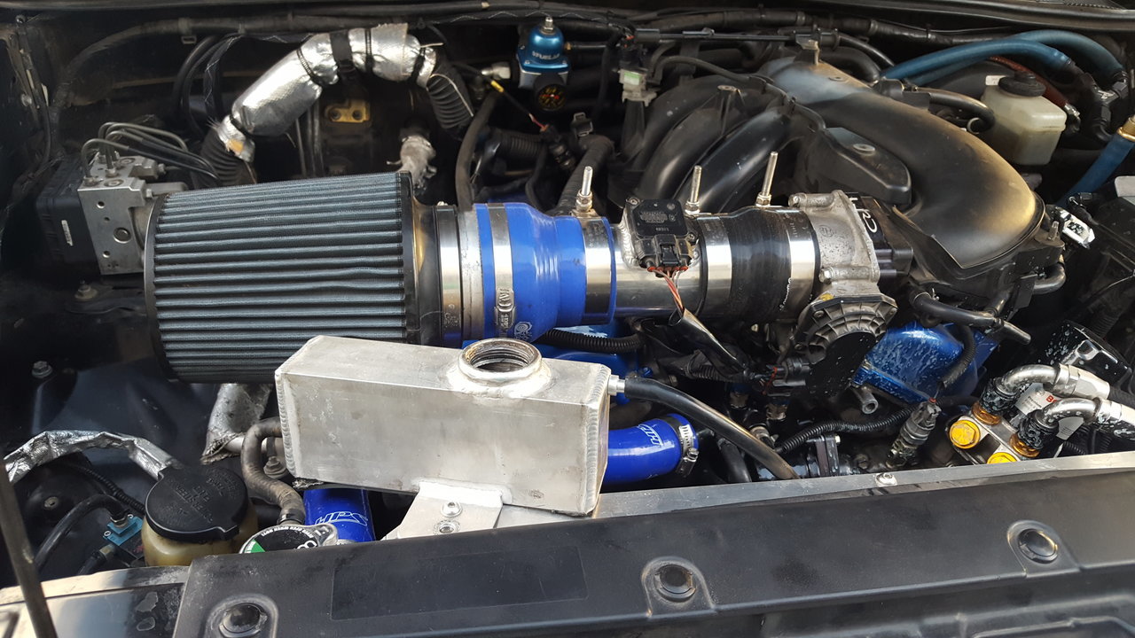

    Oh yeah. Here is a picture of my temp N/A setup.
    Had my aged Greddy filter on there. I'll go on a limb and say that 3 years max on the filter before it suicides itself. :boom:
    Need to get a larger reservoir on there, and find a good placement. Where it was on the fender, will be in the way of the turbo once reinstalled.

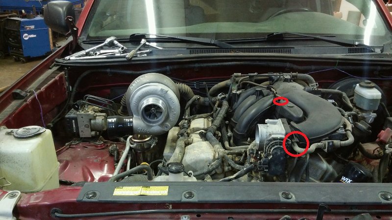

    upload_2017-11-6_15-42-30.jpgdoes any kind of clamp or zip tie need to go on these lines? they are just like slid on there, did you have any issues when you were running ~14 psi?
