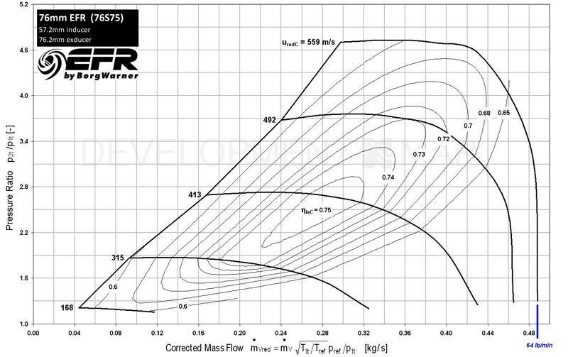

    This is the map that made me jump on the turbo. A very broad efficiency range. I will be limited to like 600 with this turbo, but it will be fantastic for transient throttle response out of boost
    :burnrubber:

    And thats where volumetric efficiency plays a key role. Once that harmony is achieved, beautiful things happen :)
