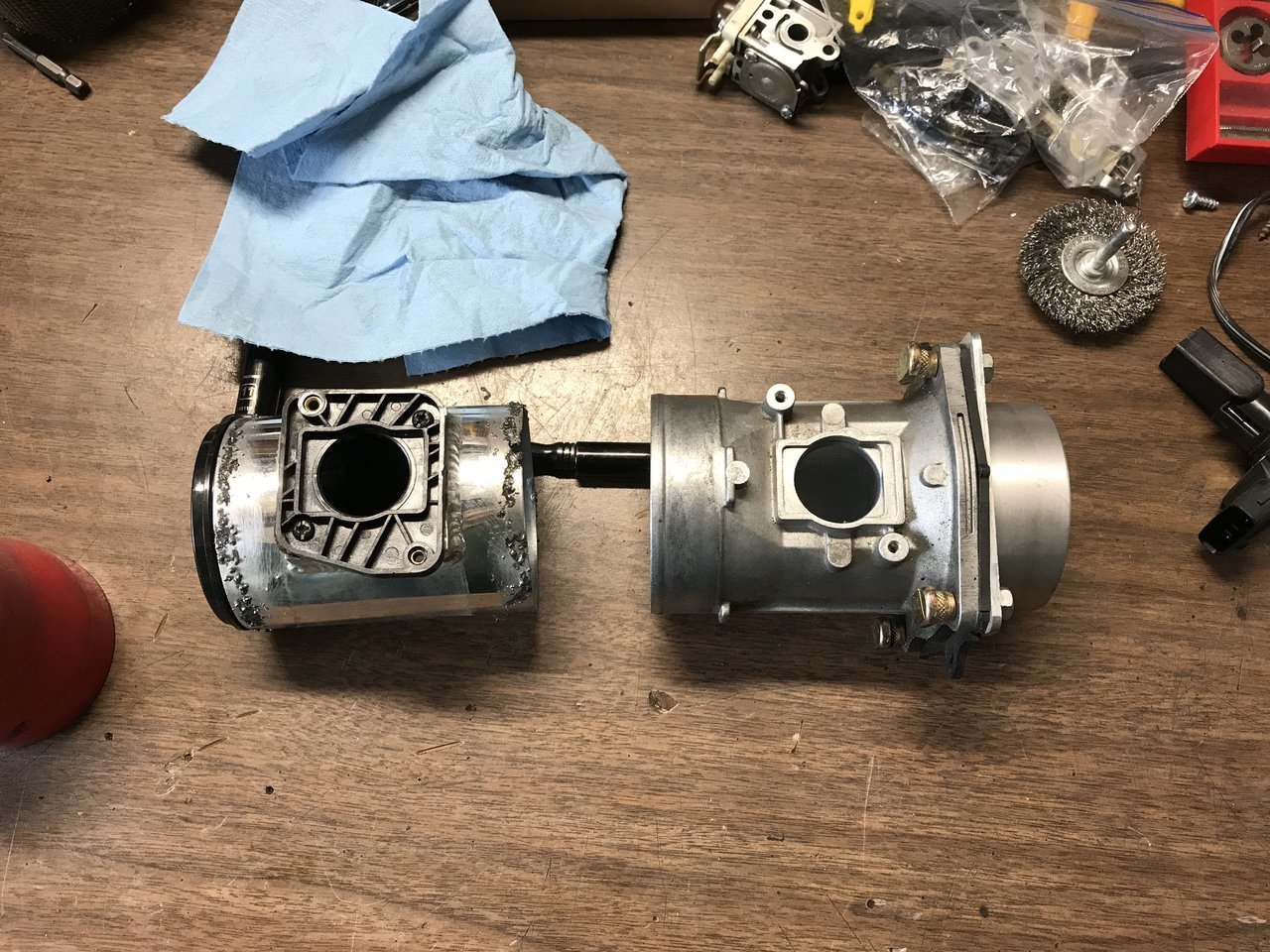

    24EE2B44-67FA-49DC-8F32-7C7D27C648B8.jpg I’m going to put the original maf adapter in place of the spectra. I’m pretty sure it won’t leak.

    After changing the maf adapter the vacuum went from -10psi to -13psi at idle. I must have had a vac leak :notsure: I cleaned the maf sensor but still having the intermittent hesitation on acceleration.

    Right now I have the PCV valve going into the opening at the back of the valve cover to the large opening on the intake(original location) and the front opening has a filter. I have been having oil push-up through the spark plug wire sockets. Is there another way to route the PCV valve where it won’t have so much pressure in the crankcase ?

    If the front just has a filter you are sucking in unmetered air through it if your MAF sensor is still over by the air cleaner

    hx989 is right you have a big vacuum leak from the front breather it should be hooked to the intake post MAF pre turbo. If you are worried about oil in your turbo put a catch can on it.
    If your still getting excessive crank case pressure you should check to make sure you PCV is working, or install a separate check valve. You should also change that line when it collapses it is not sucking/letting the pressure out.

    Okay, so maybe remove the PCV system from the intake manifold altogether. Run the PCV vent hose to the inlet pipe of the turbo PRE MAF(if youre running if suck through style). It will promote the proper flow and also make sure you are not injesting unmetered air.
