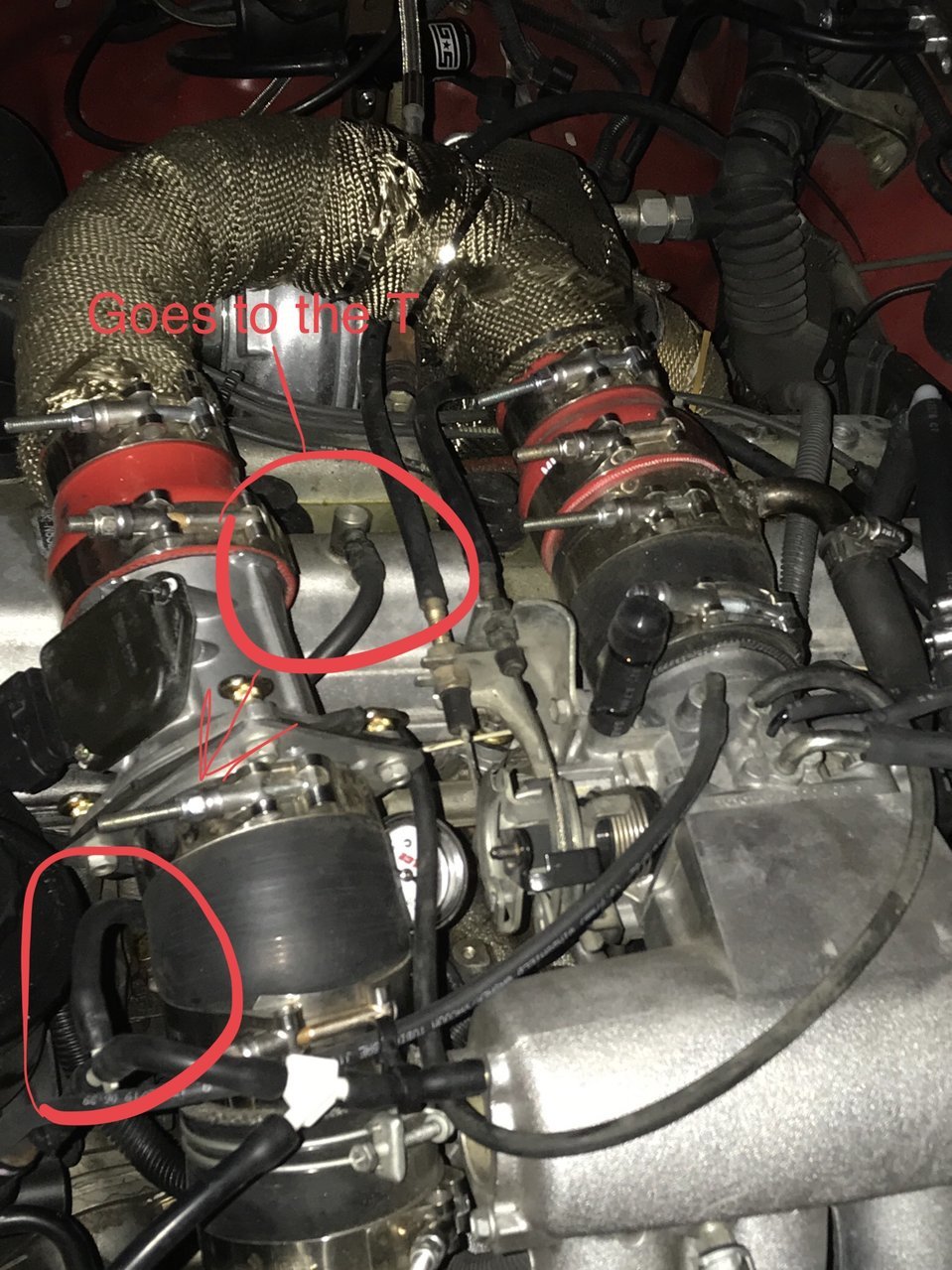

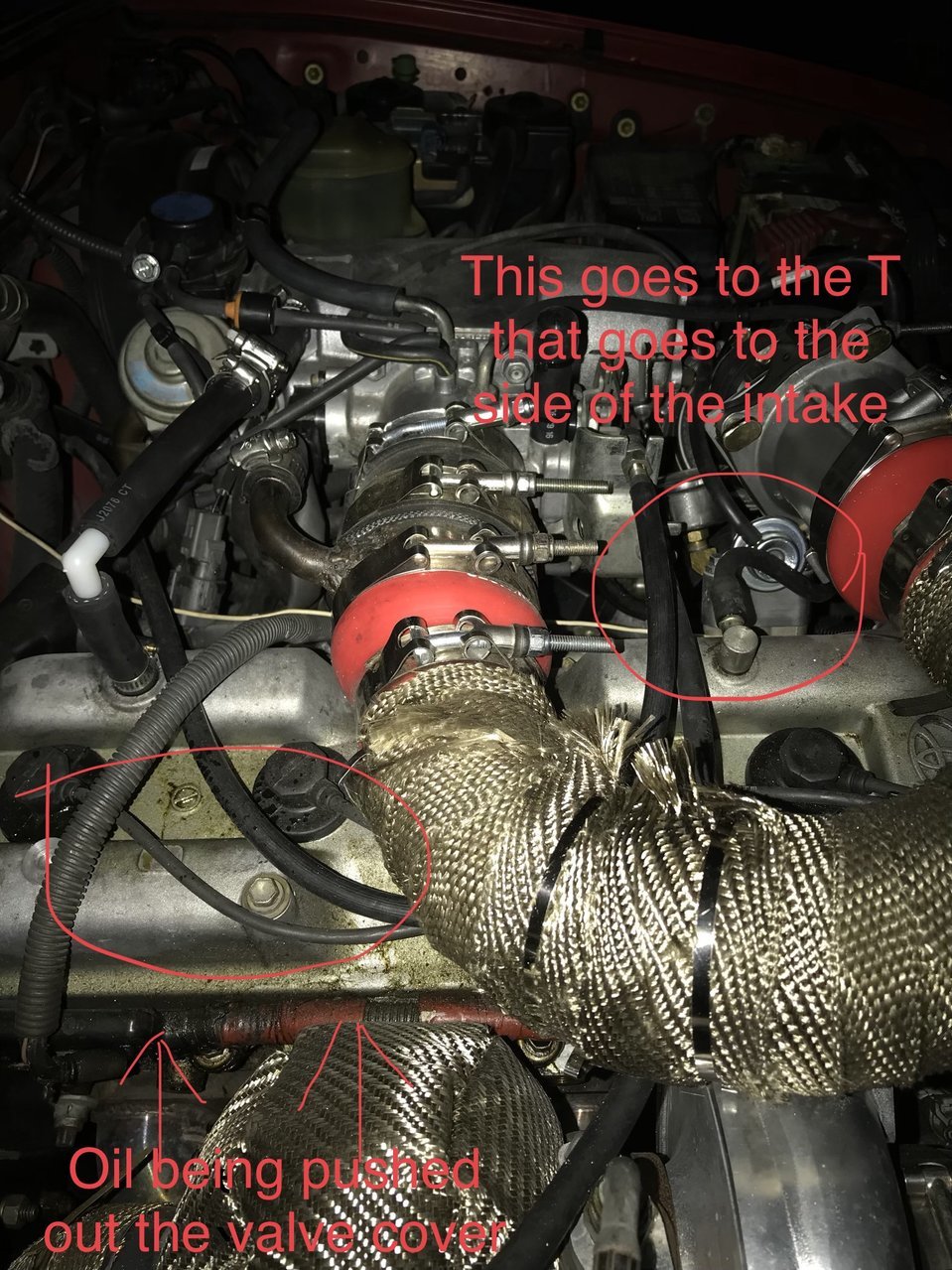

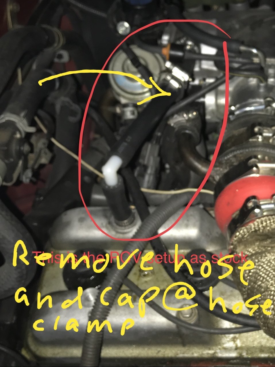

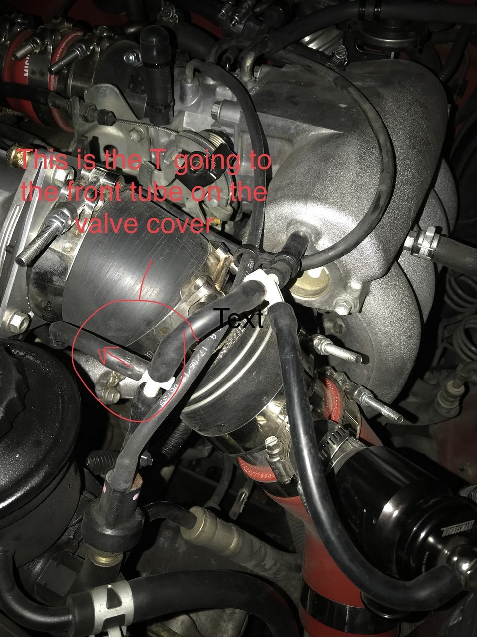

    8EE9CFB0-F173-4021-A3F6-173BA20FB36A.jpg 7AC09D46-4977-49B5-89CA-C202AAD35557.jpg 45D20FD7-DAD2-405B-AF76-171559FBCA9F.jpg 101AAA8B-F907-470B-B9DE-87C26D248DED.jpg So I rerouted vacuum lines today but now oil is coming out from the valve cover. I need help I still don’t get how to route this for some reason :help: please.

    Take a pick of your whole engine bay I can draw a picture to show you where it will go. The way it is now the valve cover is seeing boost thats why oil is coming out.
    MadTaco461 and yota243 like this.

    At this point I am with Torspd, just vent them to atmosphere.
    Jstand and Torspd[QUOTED] like this.

    Do that. Clean the oil. Test drive.
    We can worry about routing afterwards.
    @arcenik should have you covered.
    Jstand likes this.

    That’s it :facepalm:I’ll do that in the morning before work

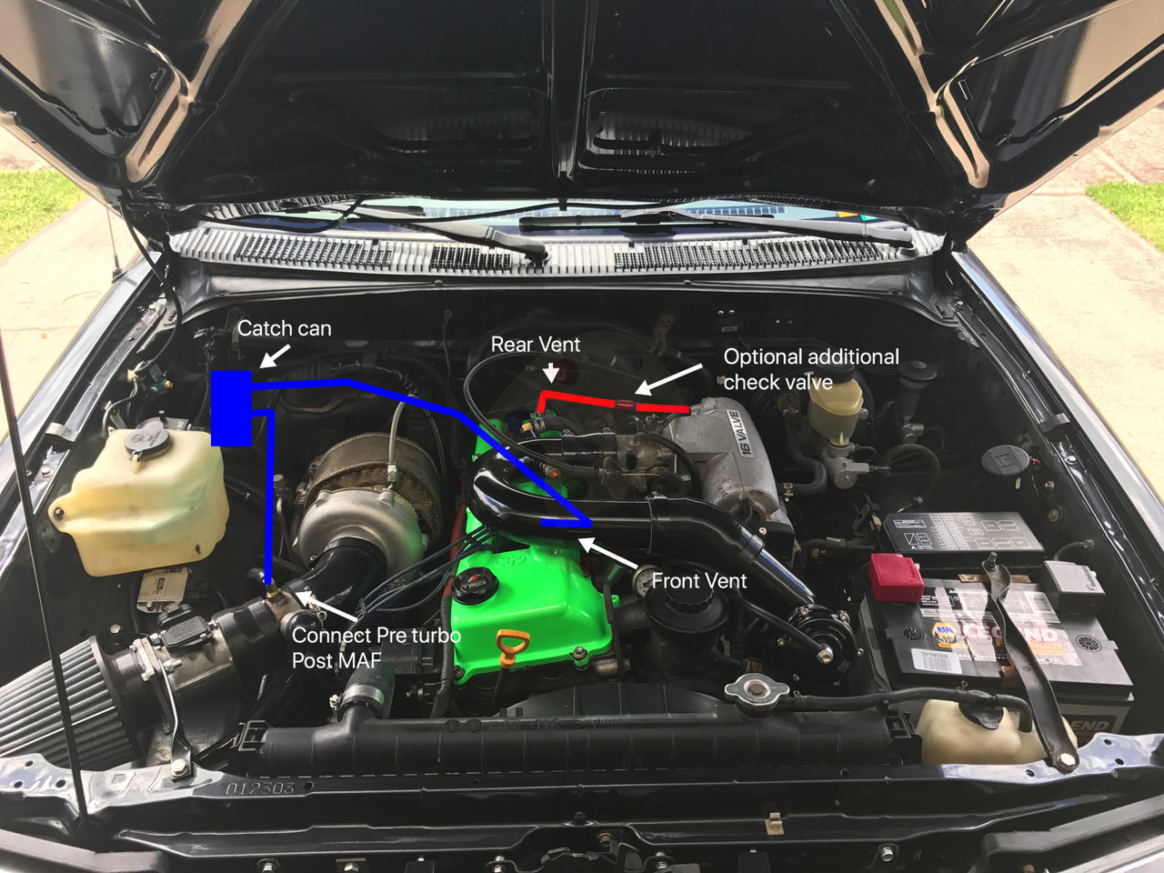

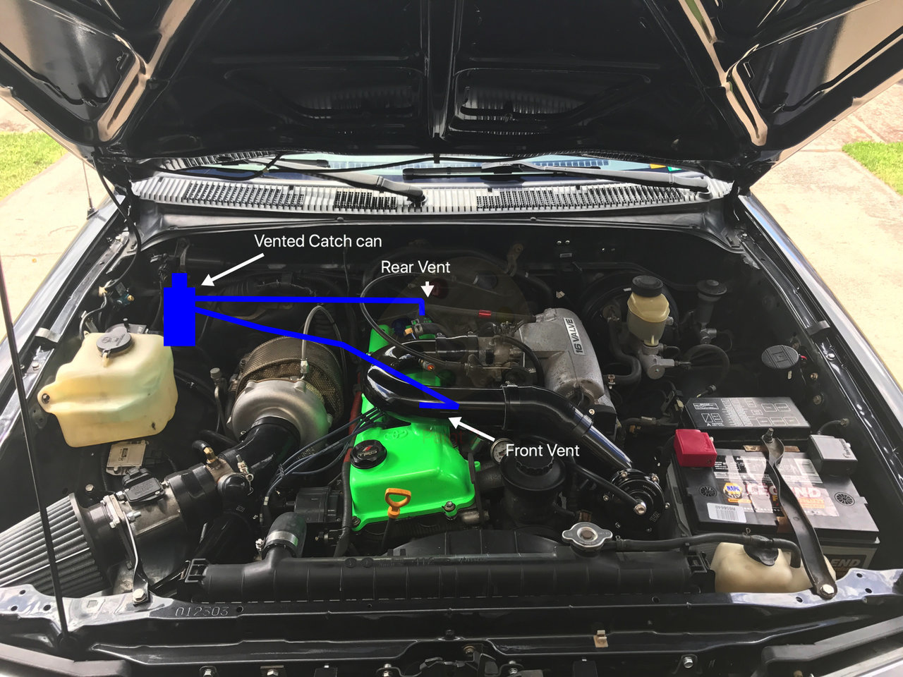

    Here's the two options I would use, there are also other options.
    I found an old pic with a MAF to use.
    Option one recirculated
    Option 2 vented to atmosphere
    Also please don't kink the hoses like the drawing, and use as big of hoses as you can.

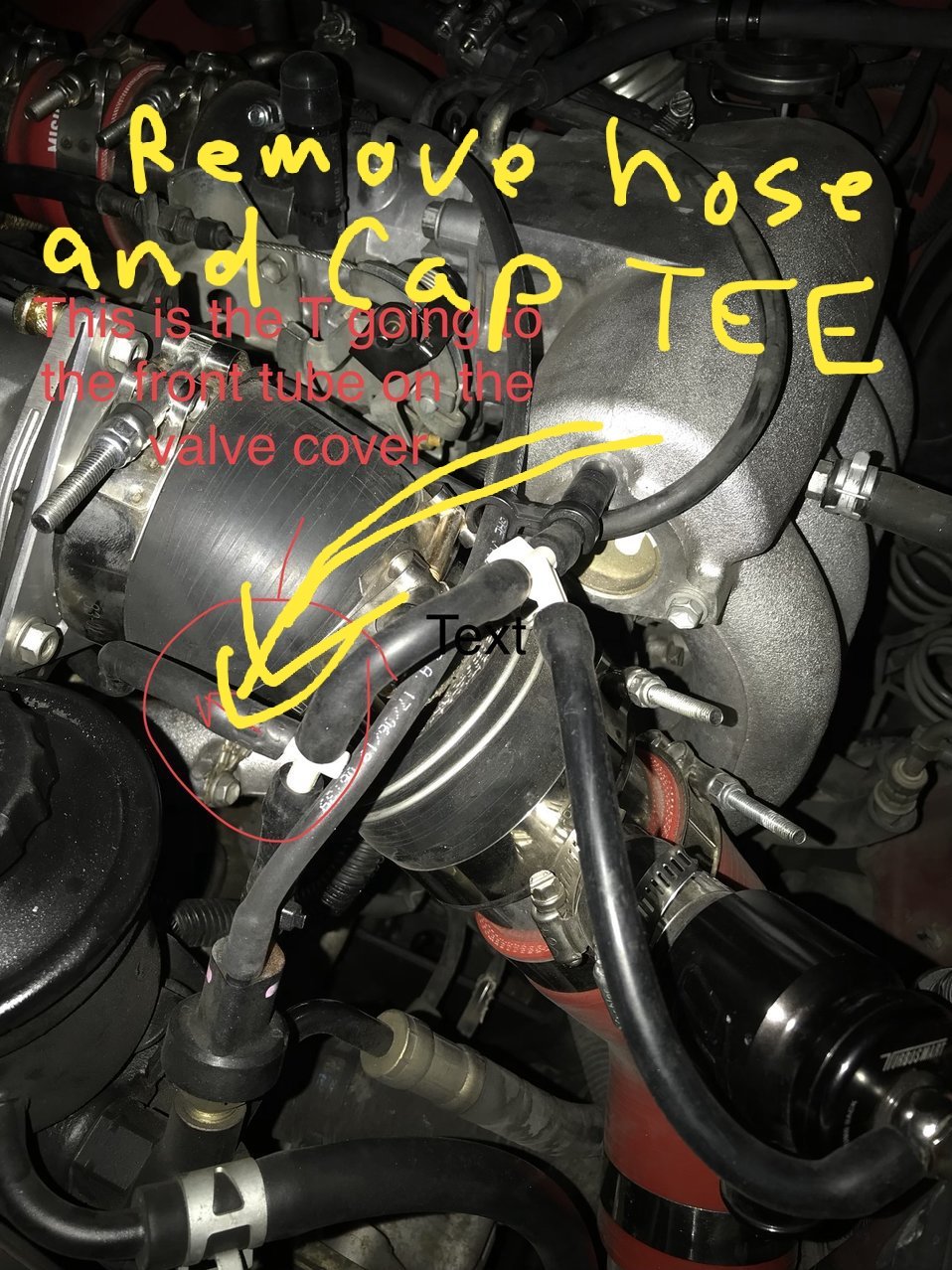

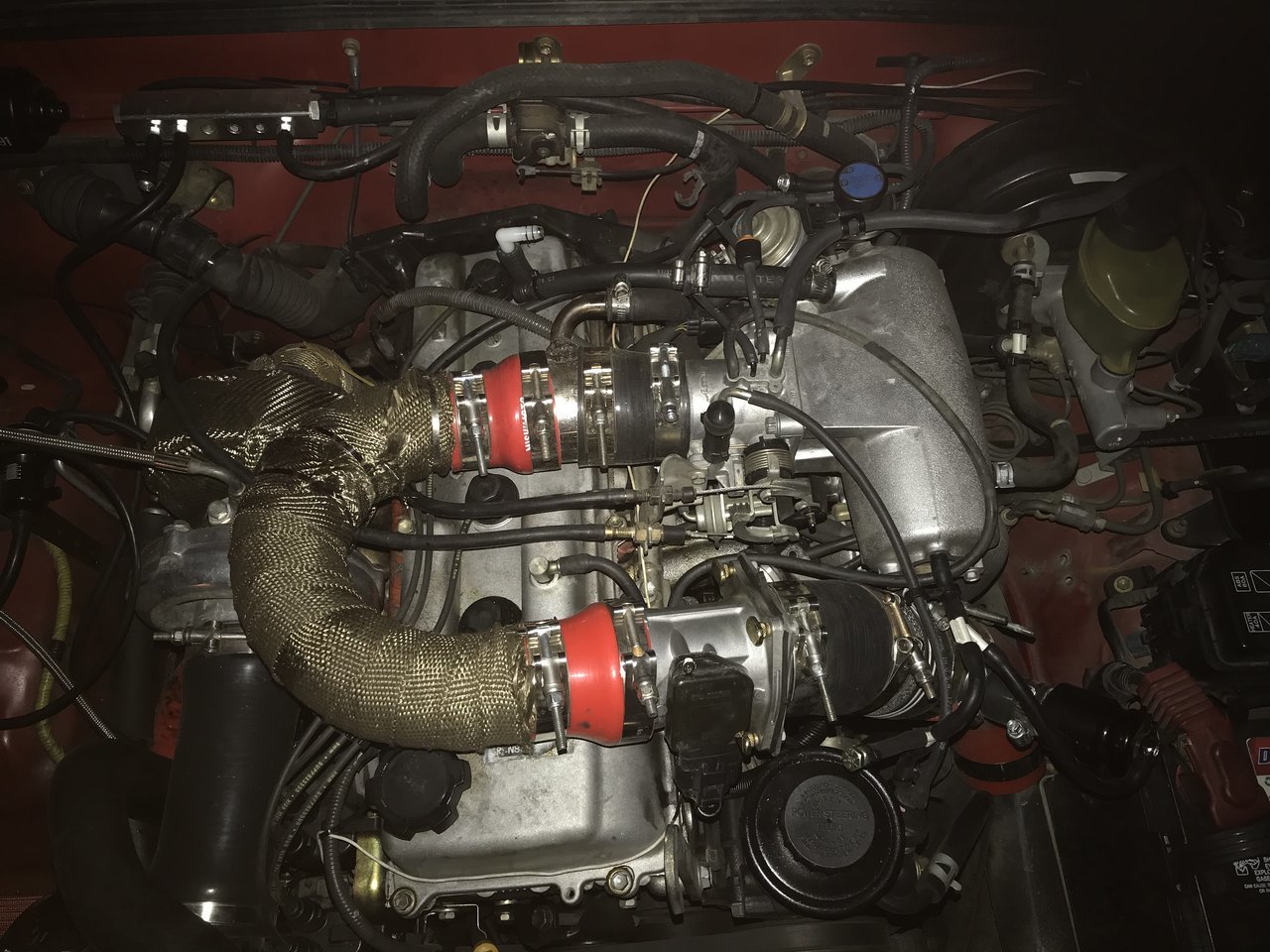

    I went ahead and plugged the two lines for now. My engine compartment is a mess:eek:44C53BCC-DA88-4366-811B-44641F262A2F.jpg
