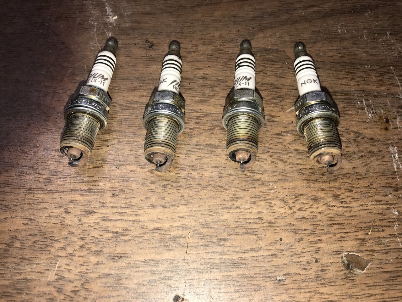

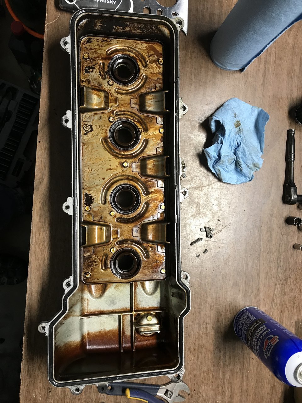

    I definitely needed to change these 4E44CE0E-4C68-495B-87FD-1F0EBF31E048.jpg and the spark plugs were pretty consistent 02049F71-B62D-4706-A96B-A573F125413F.jpg

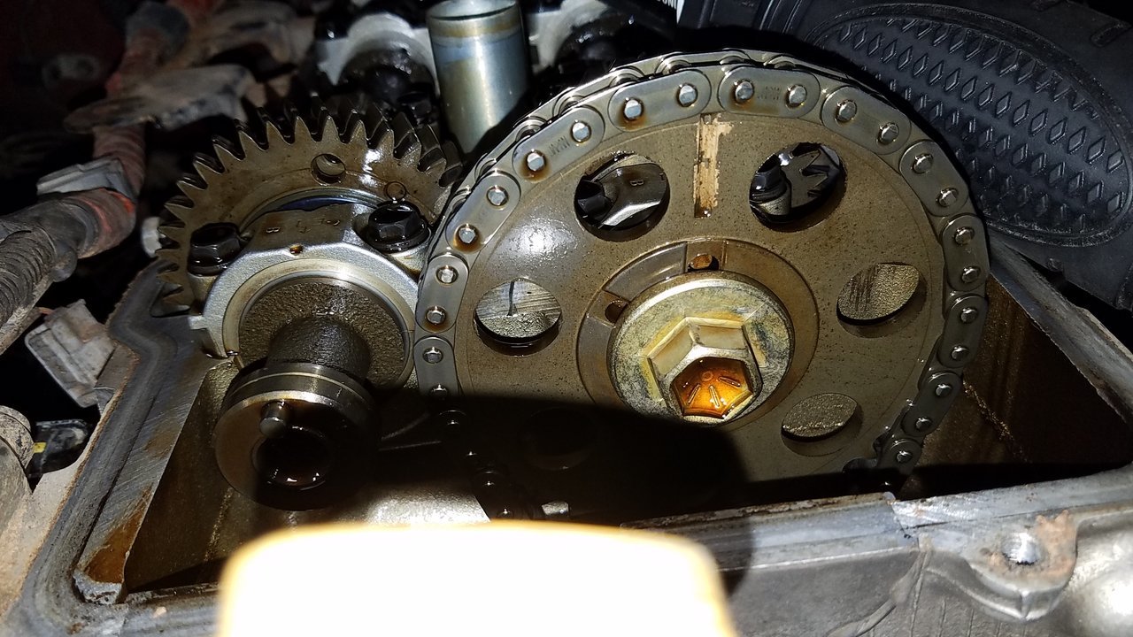

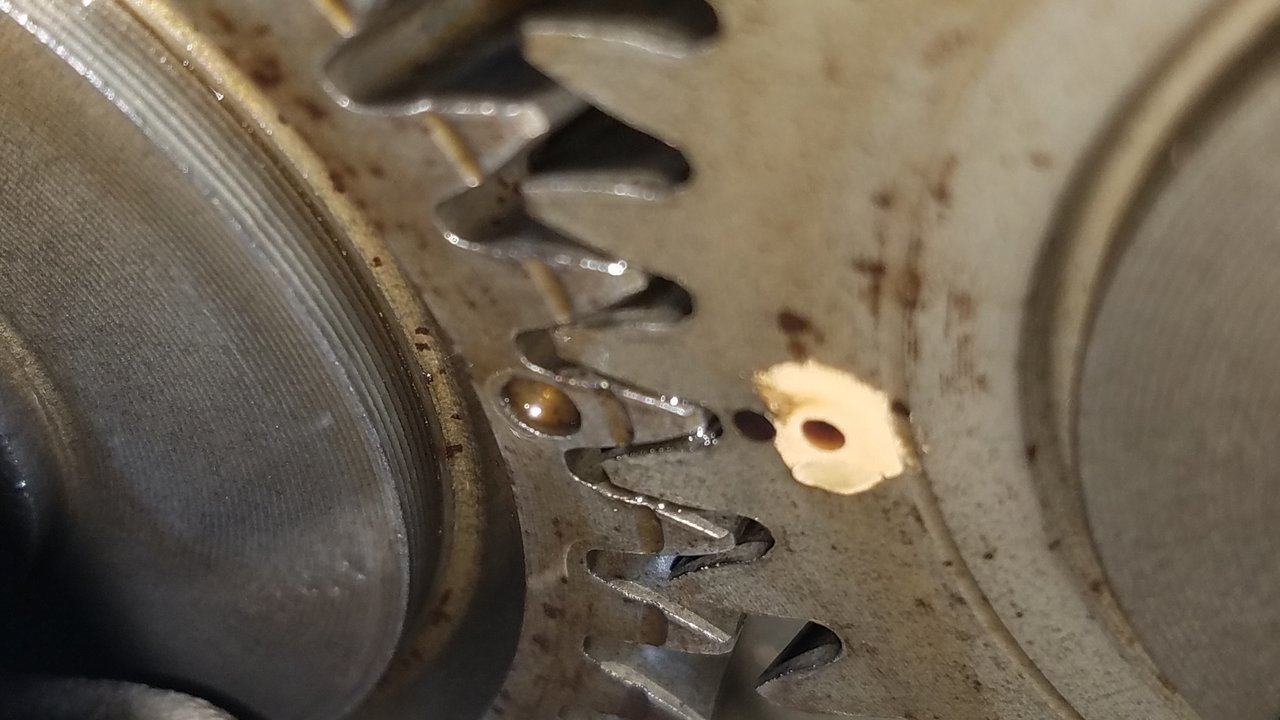

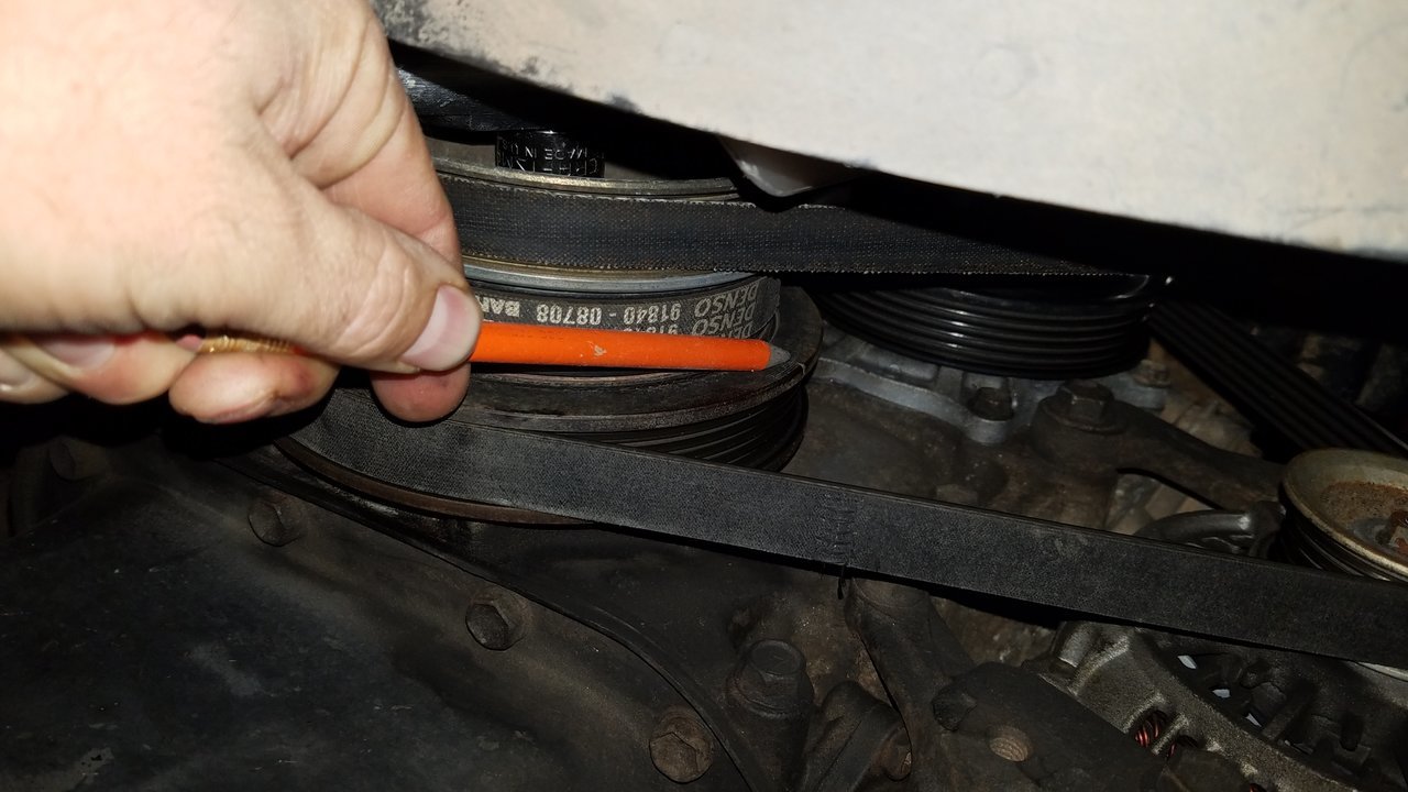

    So I checked my valve clearances today on my 3rz. 5 of the exhaust valves and 2 intake valves are out of spec. All tighter than what they should be. Most of the the other valves were right at the minimum threshold for clearance...i guess maybe thats why my motor isnt running correctly under boost?
    Also, I was trying to find tdc and I was freaking out because the dots would not line up on the cam gears and balancer pulley. Come to find out the pulley Mark is at around 3 o clock when tdc...?? Am I doing it correctly? The pictures are at tdc. Does it look correct?

    cyl #1 should be at TDC.
    Pretty normal for 2/3rz valves to get tight. recommended to check valves every 30k.
