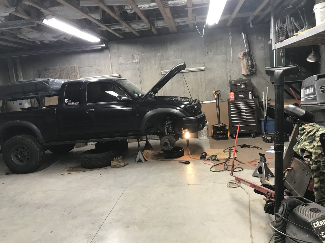

    Draining the oil pan! Dropping it soon!458FE83B-E72F-4BED-94DF-24F2C01EBD65.jpg
