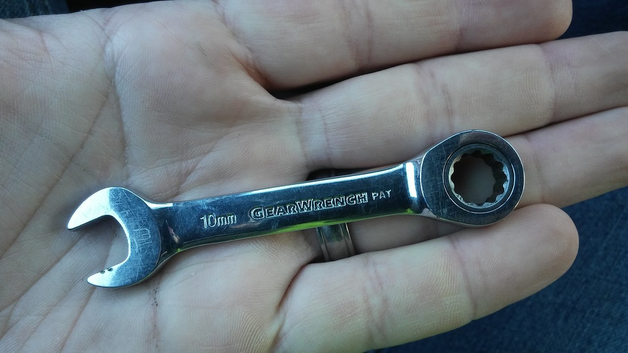

    You can break a Toyota down to a frame with one of those lol
