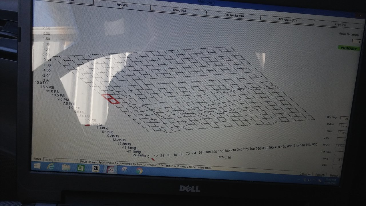

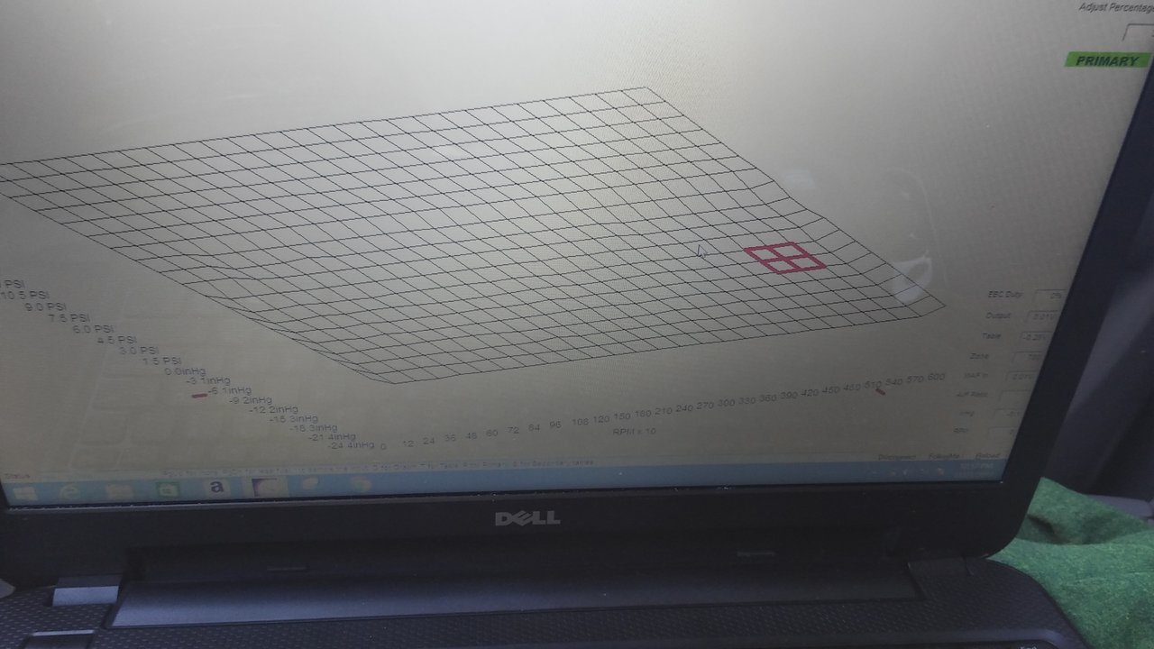

    I went and took everything less than 0 psi and made it a flat ~-.29v since i had noticed 1200 rpm and -10in hg was running decent numbers and thats where that square was set. Andbits warming up now and ill reposrt back. Before and after maps

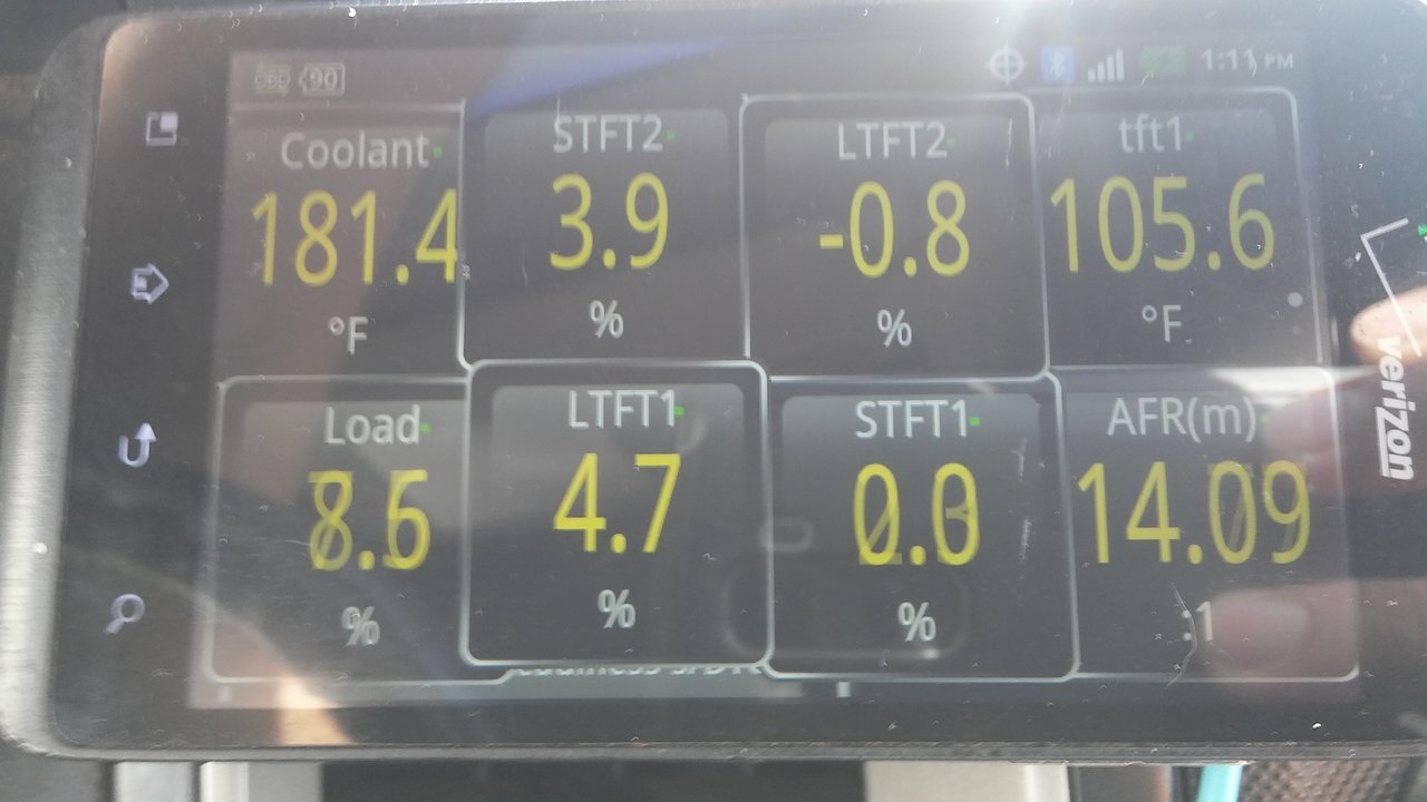

    And after a quite drive around the block... Improvement and idle numbers are looking loads better (drive numbers too, afrs stabled out between 14-15 ish but ltft a touch rich)
    20171121_131136.jpg swapped my squares around @buyobuyo

    it should have/may have occurred to me at a few different points in time, that if the stock tune was good and the table was flat, then the new tune should be pretty flat at a lower voltage to compensate for larger injectors, but plastic pieces cause problems....
