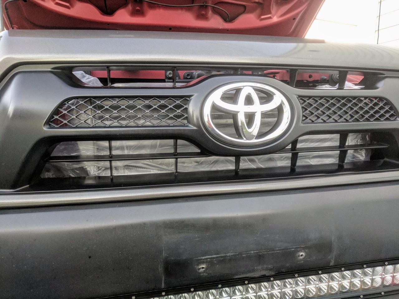

    Got my intercooler delivered, so with the 1hr I had left of daylight after work, decided to start mocking it up and checking fitment. Pretty happy so far! I'll be eliminating the couplers on the straight section with the BOV and MAF flanges, and the coupler between the 2 90 degree pieces. This will allow me to run non-intercooled at first if needed, and also make installation/removal easier for maintenance. Just have to clock the MAF so it's at 12 o'clock, and the BOV will be about 60 degrees to allow hood clearance.
    These 2nd gens have plenty of space between the grille and radiator...it's like Toyota knew we'd be modding these trucks!
    I'm able to retain the factory hood latch and vertical support, as the intercooler is a 27.5" x 7" x 2.5"
    I'll be 3D printing the intercooler support brackets, which are easy as hell, as they're just right-angle flat pieces.
    Horn will be relocated...somewhere else lol.
    Just need vacuum line, water lines/fittings, and waiting on my AEM boost gauge!

    Your going to trust some 3d printed plastic to hold your IC down?
    If its just 90º chunks, just use some angle iron.

    You haven't worked with 3D printing before, have you? It's extremely strong, and can help prototype parts before moving to other materials if desired.
    PLA has amazing strength, and I determine how much fill the part has. Intercoolers aren't heavy, and L-shaped brackets are easy to make, with extra reinforcing gussets if you're so concerned.
    I've made light bar brackets, toys, mock-up parts for RC cars, and a stepstool out of PLA that can hold my 180lb fat ass...I'm not worried about an intercooler, that's also supported on the bottom.
