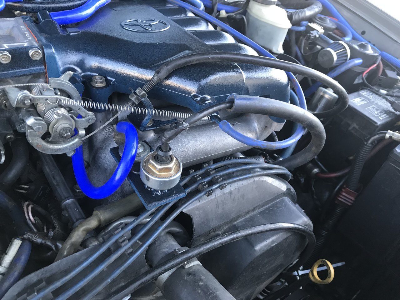

    Try it. But look for a place on the block that's easily accessible, and mount the sensors there temporarily. No sense ripping the intake off every time you want to swap out the sensor for testing. Make sure it's on the iron block though

    It can be mounted in different places on the block without drilling and tapping ?

    What's the thread pitch?
    I just did a Nissan knock sensor which is the two wire model so I may be pipe dreaming about the ability to remote mount the yota sensor

    You can remote the Toyota motors very easy a few holes available lower on the block that just need to be tapped. lLCE and paradise both recommend it and when doing so mount it lower on the casting if going fully forged because chomolly can sound like knocking while warmed up. I’ll probably move mine down there anyway because then it can be sort of gotten too

    I know it’s frowned upon to not have the knock sensor on the block, but mine has been very reliable at 8 PSI for two years and 1 year prior to that at 5 PSI. It took me less than an hour to hook up.

    Do you mean that you deleted the knock sensors ? Oh wait did you put it in the intake ?

    He just relocated his to a more accessible location
