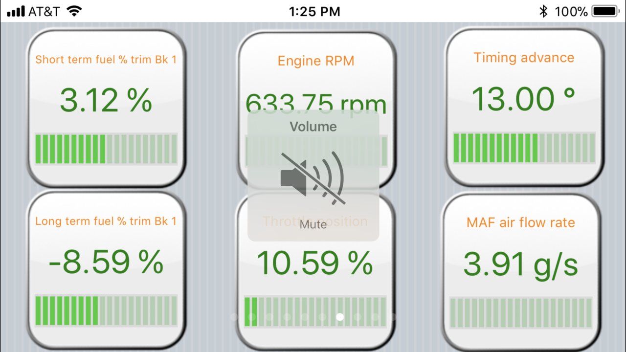

    Here’s what mine looks like at idle. I don’t know how accurate this app is. I have to figure out how to do a snapshot at WOT.85AB31AE-5937-4D7C-82EB-329D232B0553.jpg

    You trim out those 440s just fine at idle. I’m surprised what you can get away with on the stock ecu

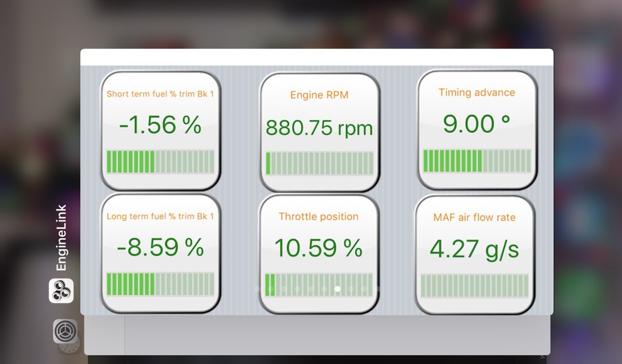

    Here is another one same throttle position without the volume in the middle.9EDB2AF0-ADF1-428D-AB37-504755F3F886.jpg

    It’s called EngineLink

    Those trims look good! Maybe the whole 440cc myth/misconception was that they are the limit of what the stock ECU can handle.

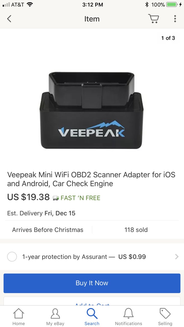

    I was able to find it on eBay which is where I got.3C97025A-28C4-417D-BF3F-56591CEC51CF.jpg This is the one I’ve been using.

    It’s hard to say. Just because idle looks good, it’s good to see the rest of the closed loop map.

    It's only $20 and it acts as a wifi hotspot not highspeed though.

    In general you want your trims to be less than or equal to +/- 10 in LT or ST throughout the rpm range; I'm not exactly sure what the ECU considers too high or low of a trim though. However keeping in the 10 range you shouldn't have any codes.

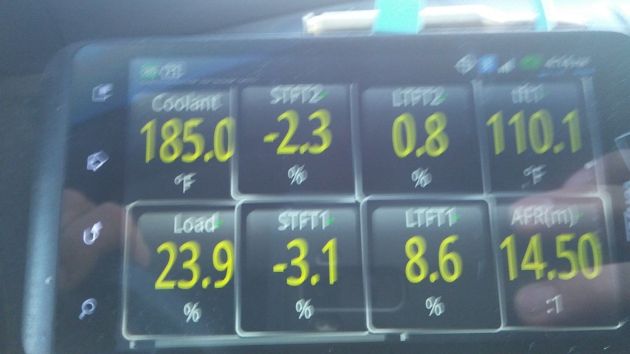

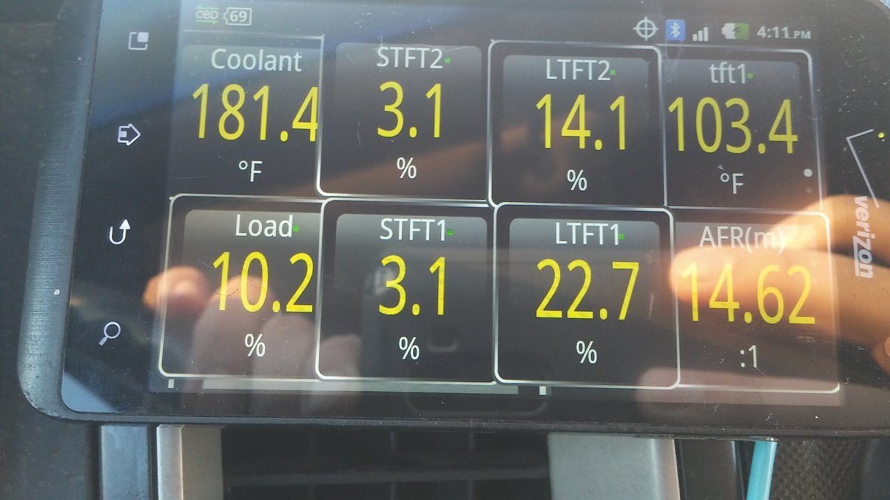

    Well my fuel go way lean at fuel cut decel and stay that way until i give it gas again (pic was taken at red light in gear foot on brake)20171212_161104.jpg but it goes pretty ok as soon as i give it any throttle like 20% load or more is great20171212_161409.jpg
    And boost trims are perfect (it started building boost and afrs didnt drop so i let off and then they dropped so i got back on it for science) part throttle boost
