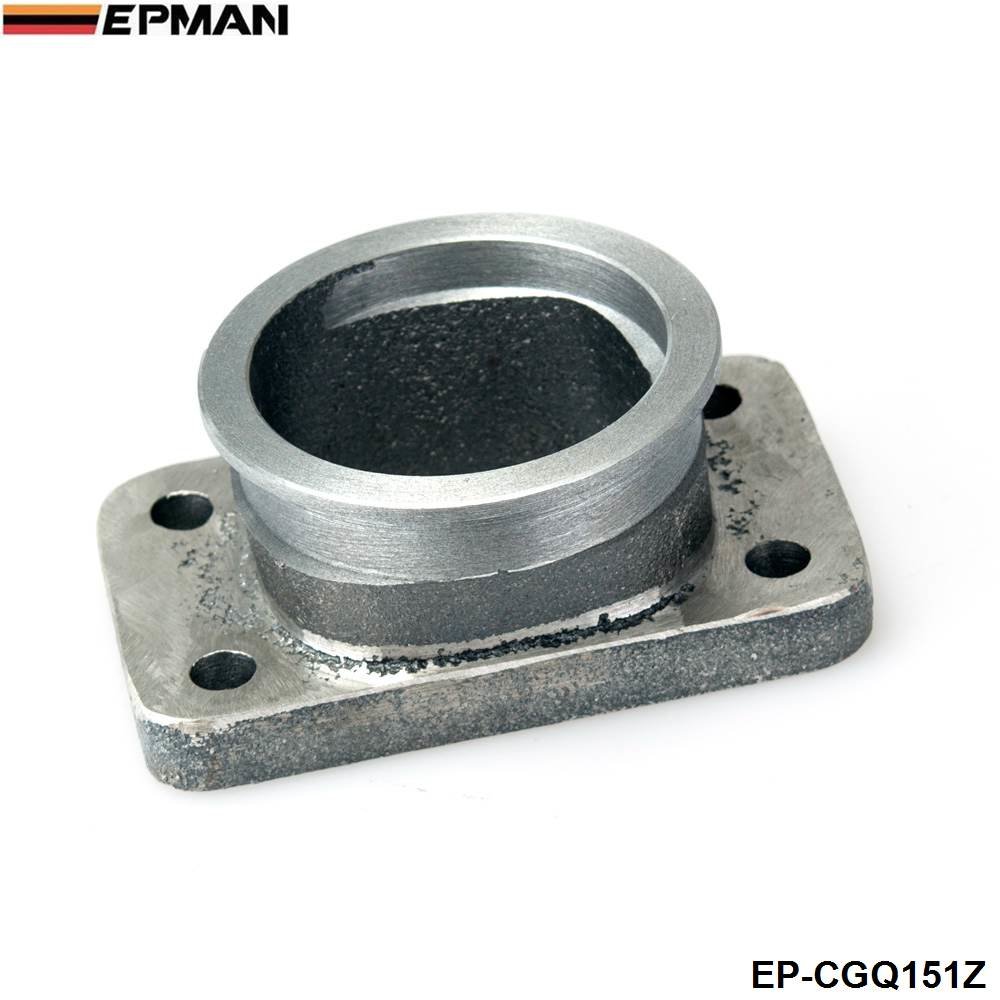

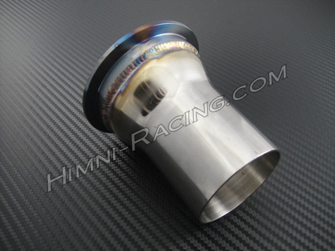

    Nah man just do this for a 60 mm wg and they make adapters for a two bolt that would contect on the vband and then put a 2.5" vband so people can use something like this, and use a t28 or t3 or t4 if they want
    3inch_to_60mm_SS_trans.jpg EPMAN-2-5-V-Band-Adapter-Flange-For-T3-4-Bolt-Turbo-Casting-Iron-V-Band.jpg all super end user friendly totally customizable with only 1 bolt each to change
    MadTaco461[QUOTED] likes this.

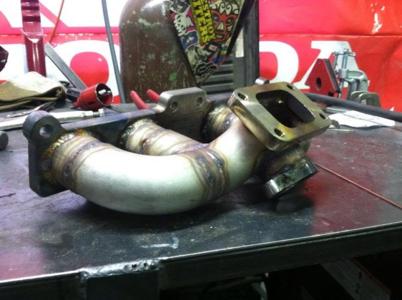

    Going that route with the low cost SS plumbing pipe sch 40. Elbows are only $5 to $8.
    If my newer design manifold design isn't too big of a pain to make, I'll make it work for a 2tr too. Only difference would be a manifold flange. It's all in CAD so to make more would be easy. I'd prefer to avoid all those adapter flanges. Less places to leak the better.
    My first thought was to just make a quick and dirty manifold like this.
