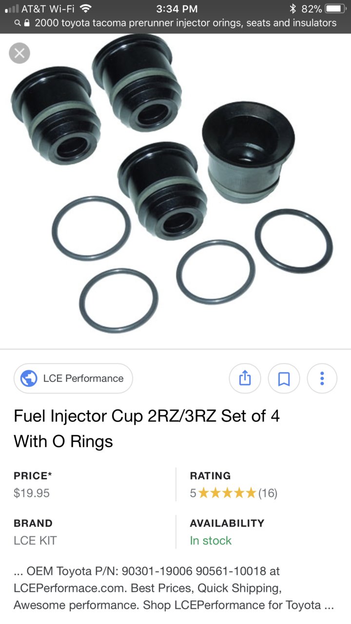

    I just spent the last 5hrs replacing fuel filter and intake gaskets only to find that there is a leak at each injector mostly #4 where it sits into the head and pressure is still lower than normal. Plus when I shut it off the fuel pressure doesn’t hold like it use to :notsure:https://youtu.be/P-fqGDCeIFk

    How snug are your injectors? Can taking the fuel rail spacers out make them seal better?

    I haven't been following your entire saga, but how careful where you when you installed the injectors? Those orings on them are EASY to wreck if you don't lube them or if you catch an edge or twist them or look at them wrong or think bad thoughts about them.
    Might just need to put new orings on and lightly lube them.

    They are tight enough that I can barely move them but I could take one spacer out of each and shim with washers to get it a little bit tighter. This gradually started happening.

    Do your injectors use o-rings on the bottom, or insulators?
    When installing into the fuel rail or manifold, a good practice is to lube them up with Vaseline.

    I have generally never been able to reuse the stock orings. Get new ones and put a little dish soap on them to keep them from tearing.

    It’s the bottom end that is leaking but I know what you mean about the o-rings

    I wonder if the e85 did this. Seems to be leaking where the insulator seats into the piece that is in the cylinder head.

    It looks like I need these but not sure why fuel pressure is dropping.BE260B05-7C2E-47FD-A070-89AB45678A3A.jpg

    You dont have any of those installed???
    Got any noticeable fuel leakage around the injectors?

    Yes they are but when I do an air leak check and spray soap bubbles come out of all 4 cups

    Are injector cups difficult to put in
