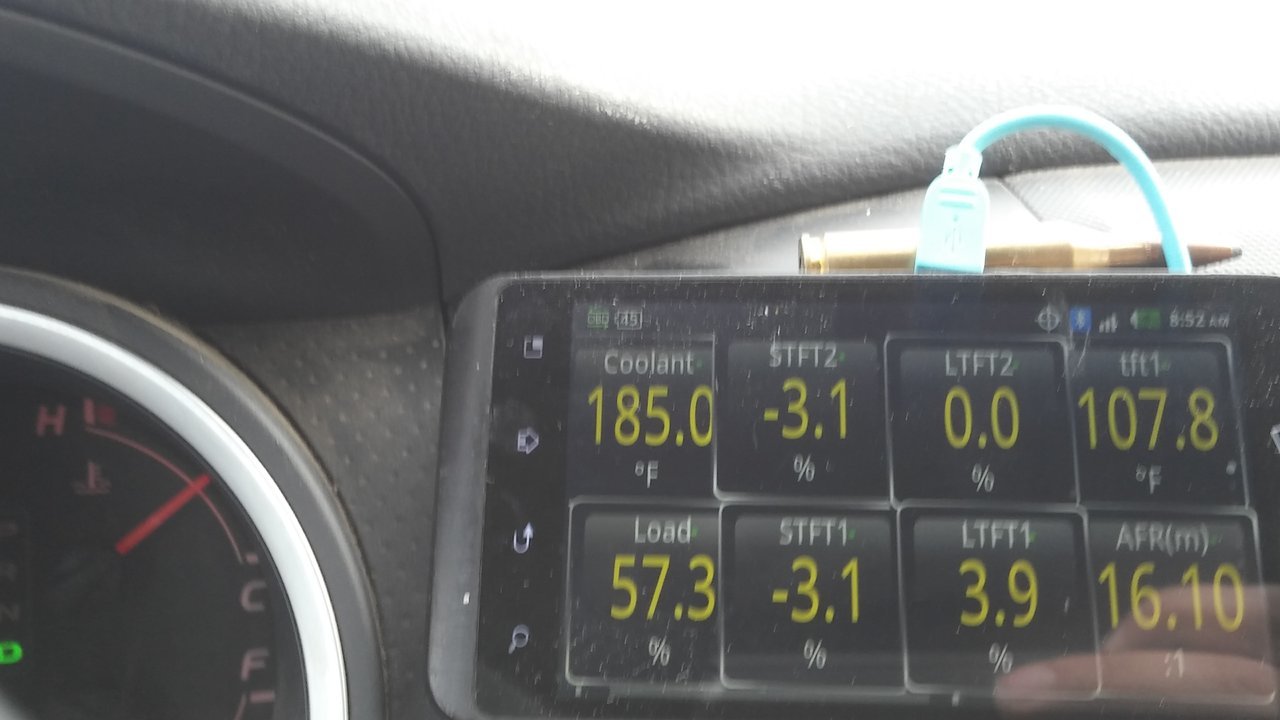

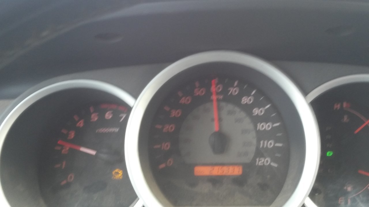

    20171230_085156.jpg 20171230_085212.jpg 20171230_085218.jpg (no boost in pictured just when i got up to cruising speed) boost started spoolin basically as soon as i gave it any skinny pedal, 2500 rpm ish
    Jstand and 05Taco4x4 like this.
  11. Dec 30, 2017 at 10:18 AM
    #5171
    Torspd
    Torspd Tor-nication
    Sep 18, 2009
    #22958
    26,464
    Tor
    The Great America!
    MMVI 4.4L 4x4 Access Cab
    Torspd Custom Turbo kit [] Borg Warner 9180EFR Turbo [] Haltech Elite 2500 [] TiAL Q BOV [] TiAL V44 Wastegate @ 15psi [] CP Pistons [] CP Carrillo Rods [] ARP Head studs [] ARP Main Studs [] ARP Header - Head Studs [] Ported Heads w/ 1mm oversized valves intake/exhaust [] Brian Crower Forged Stroker Crank [] Darton M.I.D. Sleeved Block [] Kelford Camshafts [] Torspd 160* T-stat mod [] APR Large Fuel Rail [] Walbro 460 LPH E85 Fuel Pump [] FueLab FPR [] APR T56 Conversion Kit [] KP RACING Built T56 [] McLeod Racing Custom Twin Disk Clutch [] One Piece Aluminum Driveshaft [] MGW Shifter [] Custom lowering kit [] Ohlins Front Coilovers [] QA1rear shocks [] Custom Ron Davis Radiator [] Dual SPAL Electric Fans []
    The realization of load induced boost. Try brake boosting next. ;)
    yota243 likes this.
