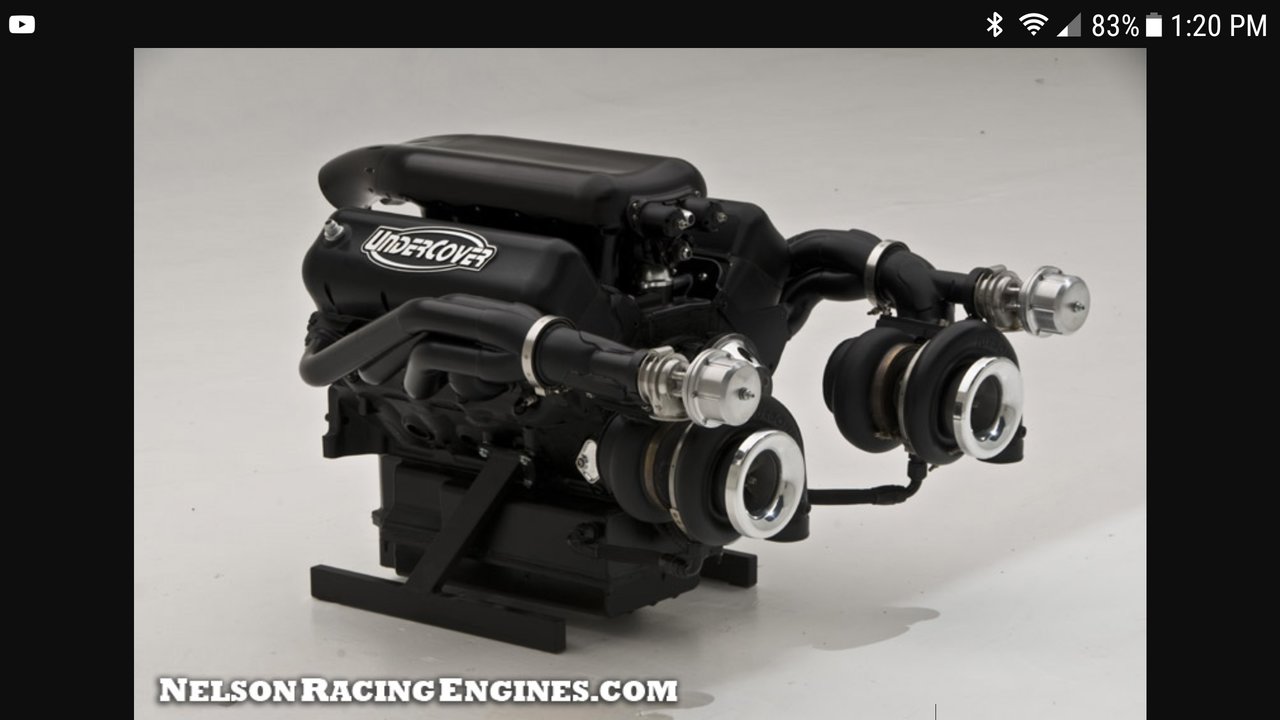

    Here is a good picture to illustrate wastegate priority. The flow goes to them first, then the turbo.

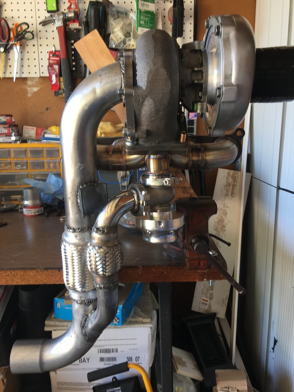

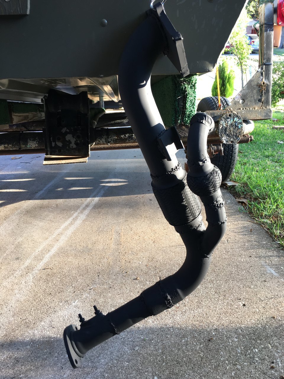

    Here is a pic I just took right now and here is another from when I was fabricating it.56EA4A1C-4C62-47C1-B82E-EF39951C3B7A.jpgthis pic were it’s leaning on the boat is before I put the bung for the WB sensor5244C9C2-F9C2-4B8C-9498-3117333C8AB8.jpg And the engine bayBBEE7660-B2D8-46FE-90A4-FA96C89CDA8A.jpg4AD28442-AF85-44EF-80EF-CDA15221A09C.jpg

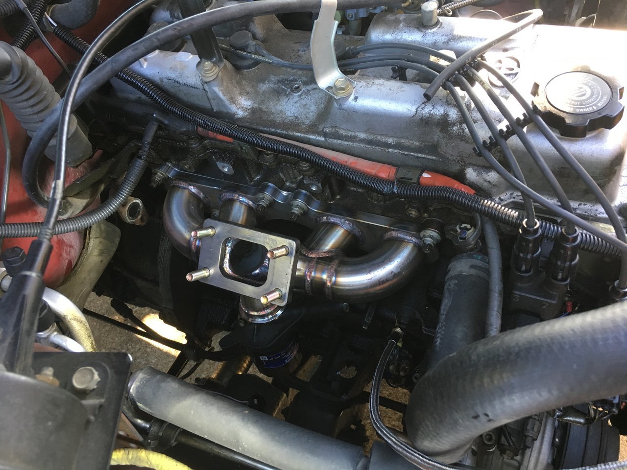

    Picture of finalized header fab?

    This is the header or manifold.D42FACF8-BDB0-4A98-BEBB-65E87D8E79AB.jpg3629AA16-66F8-4421-B1D8-05B9283E88B9.jpg And this is the Downpipe, manifold and turbo before I installed it. I hope this is good for what you’re looking for.

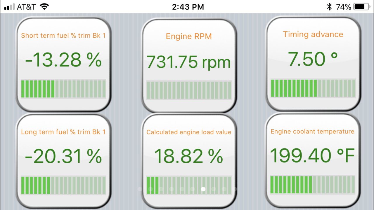

    Today I opened up EngineLink to see how everything was and to my surprise the LTFT’s were stuck no matter throttle position or load they stayed at -20.31%809262A5-6BE1-41D9-AEBD-82A02B6D5374.jpg
