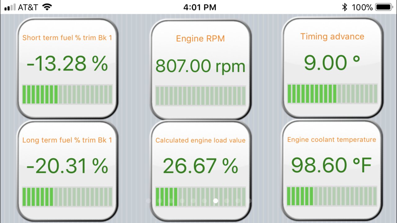

    After replacing the IAC on cold start the truck barely idles less than 500 for a minute then it’s fine. Afr’s at 10 then eventually go to 14.7 When it’s warm idle is a little high 800-900 rpm in gear 1200-1400 in N. Do I need to adjust something?

    What are your fuel trims?

    I'll have to look after work. Is there something I should look for?

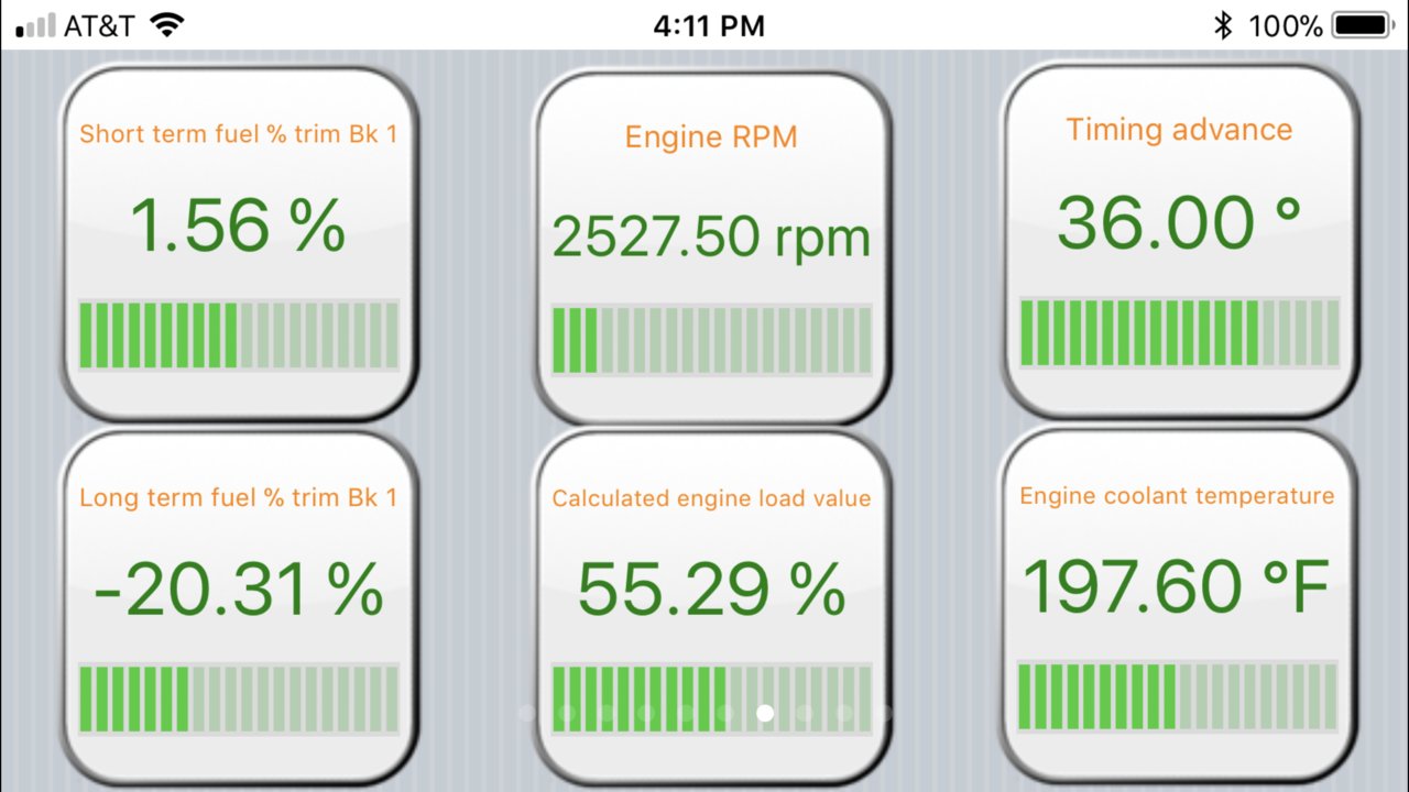

    Just curious. It is the portal into the trucks soul, and may be telling of an issue.
    How many miles have you put on it since you unplugged the battery? There is a learning time for the ECU as well so this may be a potential as well.

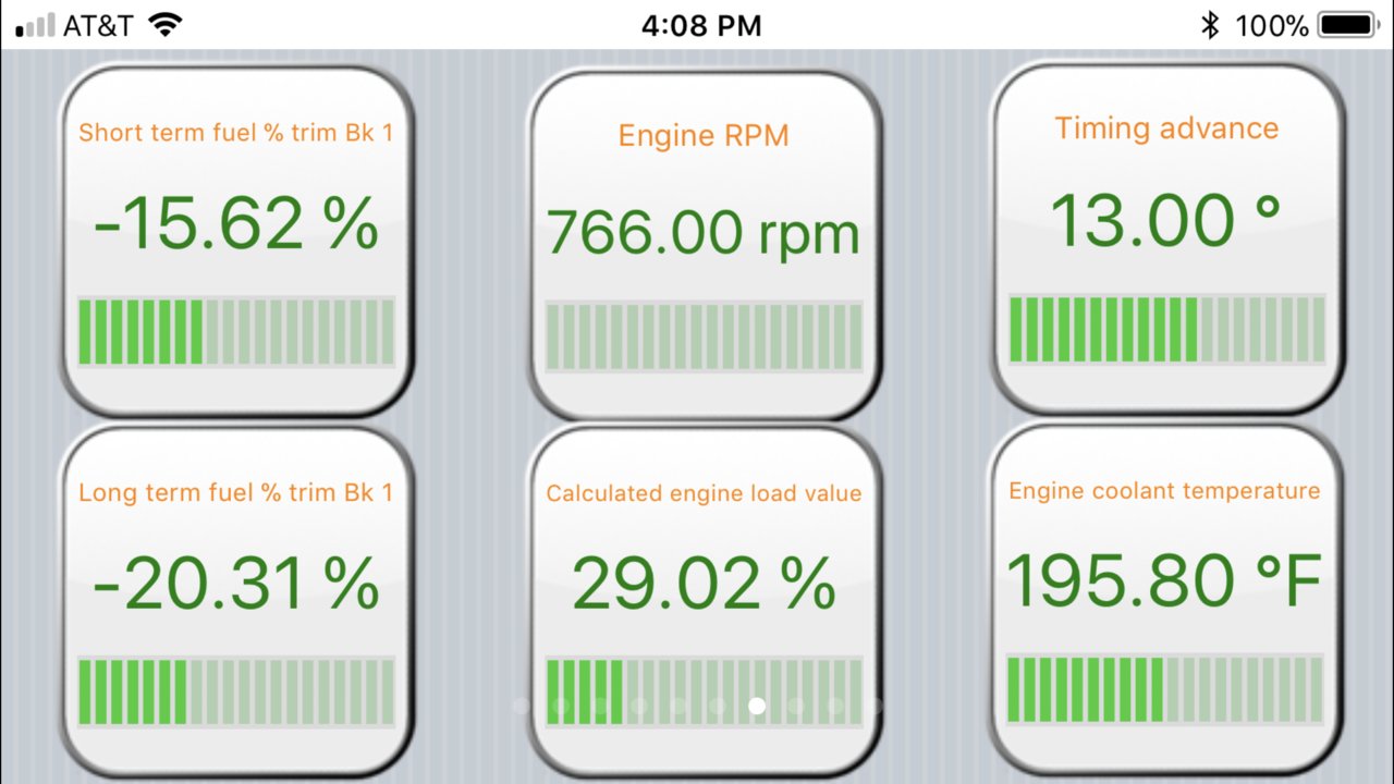

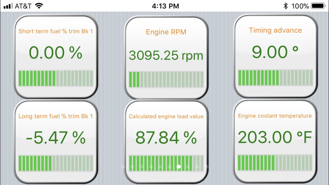

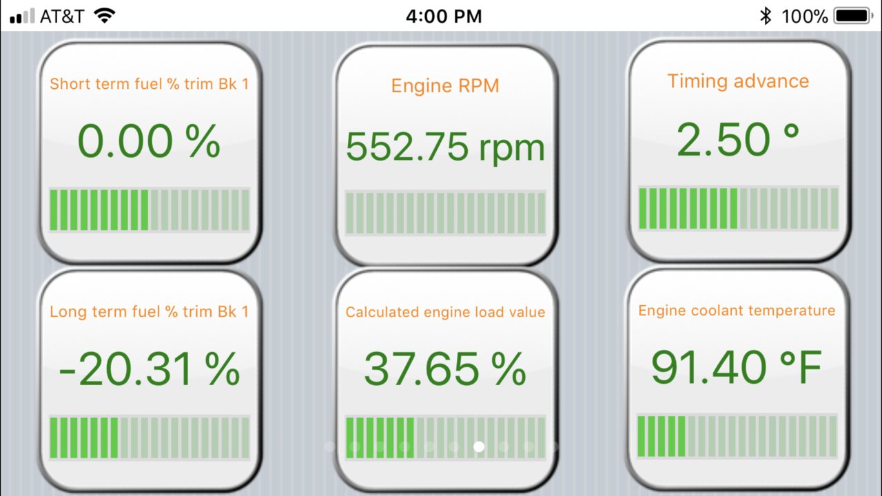

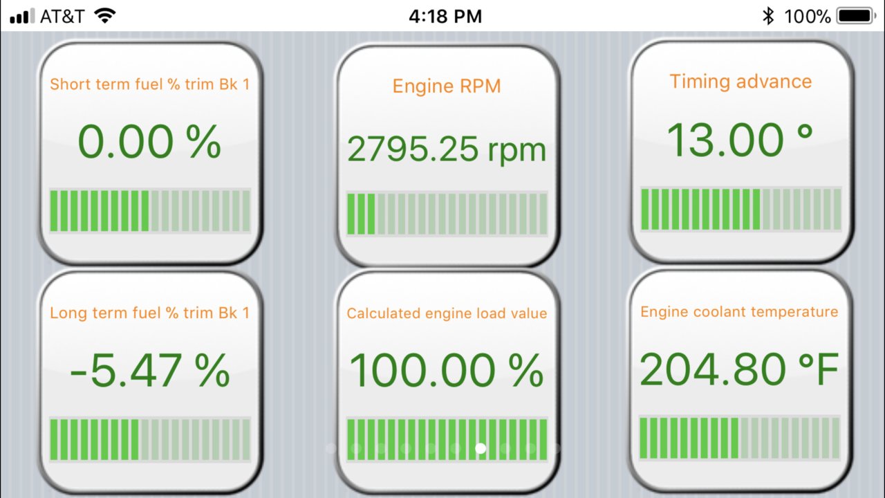

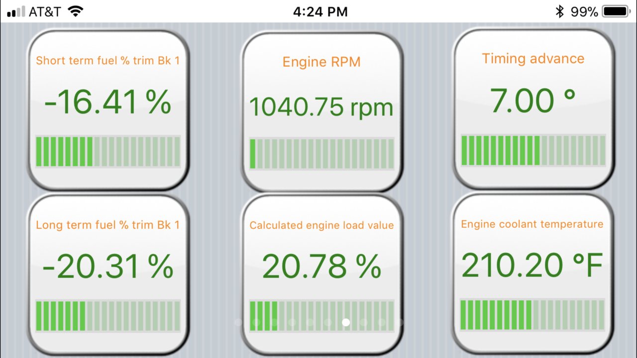

    @MrCrowntown I took several snapshots of EngineLink right when I started the truck all the way to home so this one is right when I started after sitting 2 1/2 hrs. Idling just barely with afr’s at 9.00-10.00. right at start up
    CDAD1B59-9F68-4E4A-ABD6-82E7E8FC18D3.jpg Then shortly after that afr’s at 14.7 more or less.
    F51F74CE-AB35-4A0C-A70F-803810CA2659.jpg This was almost warmed up idling.
    This was part throttle
    5A09E05F-2586-4E8C-B094-6640EB2E45A5.jpg Full throttle
    5A6FCA4F-5864-48B0-B109-356E2DB78AC8.jpgF6F91752-23D2-44C9-BC57-E186F7A72748.jpg And cruising on the freeway with afr’s at 8.3 70 mph
    A203325B-3D37-4282-98DA-B3713768BED8.jpg Last but not least idle warmed up in gear then out of gear

    You need something to tune your bigger injectors, I hate to beat this in again but you are not going to get it to run right with out something like an AEM FIC.
    Your idle is low when you first start cause you are in open loop and running rich.
    I am surprised you have not got a check engine light for bank 1 to rich.
